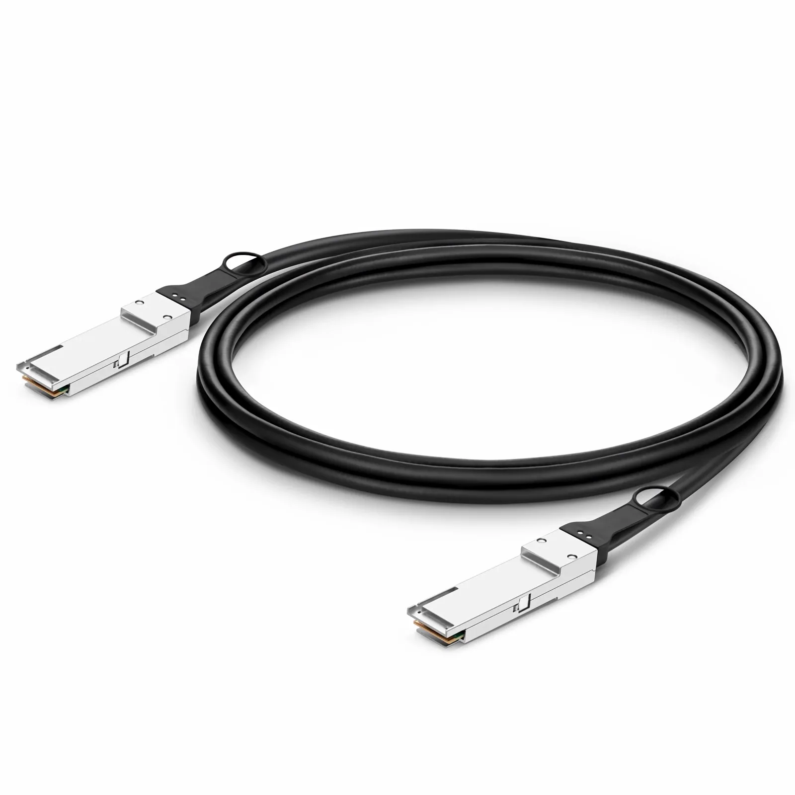

Could anyone suggest an appropriate cable to link two Sparks? They will sit on top of each other, so I’d prefer a short cable.
FS.com sells a 0.5m (2ft) NVIDIA/Mellanox MCP1650-V00AE30 that’s on the list of approved devices from NVIDIA.

There are two approved cable SKUs
Warning: this is not a good reference. You cannot use any random cable from this list. I bought the MCP1650-V00AE30 and it does not work.
I just ordered the NVIDIA/Mellanox MCP1650-V00AE30 Compatible 0.5m (1.6ft) 200G QSFP56 Passive Direct Attach Copper Twinax Cable 30AWG for DGX Spark Dual-System Interconnect from NADDOD. It is advertised as being compatible and they tell me they test each cable before shipping. I will let you know if it works.

The cable arrived yesterday and it passed the nccl-test suite. Speed is 20 - 22 GB (not Gb) per second which is about the most we can expect. So far, seems like a good buy.

Well, a direct equivalent to the “official” stacking cable seems to be this one: NVIDIA/Mellanox Compatible 0.5m (1.6ft) 400G QSFP112 Passive Direct Attach Cable - NADDOD
@eugr @PrinceHal got that cable and said it worked. It might be worth testing whether it can carry 400G or not.

The NADDOD cable seems to work fine. Now I have to learn how to use it, as in run vLLM with larger models using the two linked Sparks, or fine tune a larger model or quantize a larger model with 256GB combined RAM
Have you had a chance to aggregate two “virtual” ports and achieve 200 Gbps between two sparks in benchmarks?
I have two Sparks connected by one cable. I followed Nvidia’s directions in Spark Clustering and Stacked Sparks. Running the nccl-test script from the Stacked Sparks link I obtained 20 - 22 GB / sec transfers. Take 8 bits in a byte and allow for other overhead and that’s within reasonable expectations for a 200Gbit link. I hear it might be possible to bind two links to double the speed but would need another cable to try. When I hear for sure that people have done it I might well order another cable. I hope that answers your question (I use “bind” where you use “aggregate virtual ports” perhaps).
