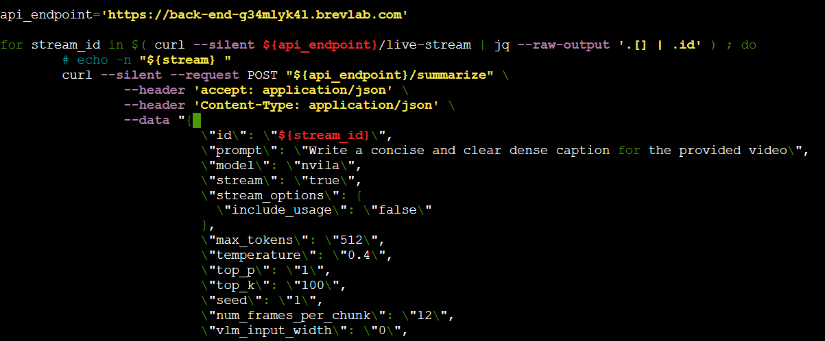

  1. We were using curl to add the streams and then summarize. The following is the code to summarize.
  2. We were able to successfully add 500 streams, but only 256 streams were able to be actively summarized by the earlier code. We looked into gradio UI to verify the active streams, and it only showed 256 active streams eventhough there were 500 streams going through the vss engine, which we confirmed with the tmp/assets folder (it had 500 uniques). The summarization performance started droping after 256 active streams too. But gradio ui kept showing only 256 active streams when we refresh active stream list. It failed to summarize for the rest of the 500 streams we added.

About the 1st issue:
  • Trigger summarize using /summarize API.
  • You can terminate this connection, VIA backend will keep summarizing the live stream in the background
  • You can then do Q&A (/chat/completions)
  • One point: vector DB will keep updating periodically as stream continues
About the 2nd issue:
  • You can add following in env using overrides before deploying:
  env:
  - name: VSS_EXTRA_ARGS
    value: "--max-live-streams 512"
