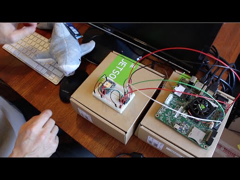

You can see a smashing video on the the UART along with level shifting here:
This thread has been open for a long time, unfortunately I just got around to playing with the UARTs. I’m sure the posters have long since solved the problem and moved on, this answer is here informational purposes.
