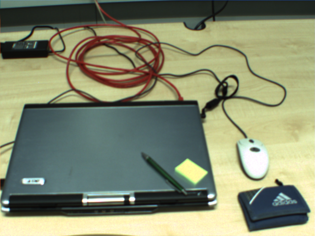

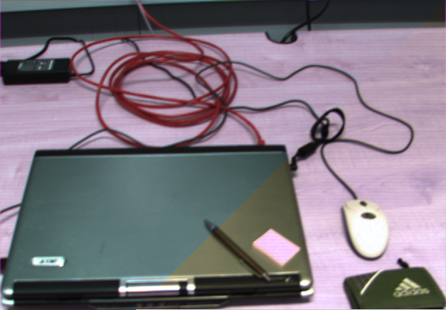

I m facing a very strange problem here.
I am doing bayerpattern interpolation, for which I use a 2 dimensional one channel texture. This texture may have arbitrary size.
Everything works out fine, but when I use a width that is not dividible by 16, my whole image gets somehow distorted (skewed, pattern locations change). I think my texture is delivering wrong values, but I’m not sure.
Has anyone ever seen anything like this? I have been hunting this bug for two days now and I’m running out of ideas.
I have attached two results of a kernel run. The first one is 640x480 (baypatt1normal) and runs fine, the seconf one (baypatt1distorted) is 627x437 and shows very strange artifacts.
Regards,
Kwyjibo
