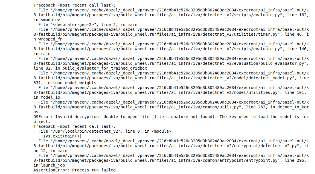

Yes I fixed this. However, I am still having errors since when I list the available pretrained facenet model. It shows an empty list. So maybe, that’s where the error is coming from.
I tried to install it manually from the ngc models. I put it in the right file and changed the model_config path. However, it is still not detecting it
I downloaded the model directly from ngc the face detect model with IR.
However, it shows the following error.
Can you download the face detect IR model from its model card https://ngc.nvidia.com/catalog/models/nvidia:tlt_facedetectir/files ?
And its key is tlt_encode

Concerning the load_key. I set it to tlt_encode. However I am still having issues even though I used the facedetect model not the IR.
What do you mean by “I used the facedetect model not the IR” ?
I am working on the facenet model (face detect) provided by the transfer learning toolkit.
For the pretrained model, there are 2 version either with IR or without from ngc.
So using the pretrained model without IR give me the OSError: Unable to open file. And using the pretrained model with IR give me the dimensions error. I will resize the images as you said. I will resize them offline 384x240 images and see if it will work.
However meanwhile, I am trying with the pretrained model without IR.
For https://ngc.nvidia.com/catalog/models/nvidia:tlt_facenet, according to its overview,
its key is nvidia_tlt

It shouldn’t be since the label is different.
“This model accepts 384x240x3 dimension input tensors and outputs 24x15x4 bbox coordinate tensor and 24x15x1 class confidence tensor.”
Any remaining issue?
I converted the dataset into 384x240 images. However when I trained the model, another error occurred:
