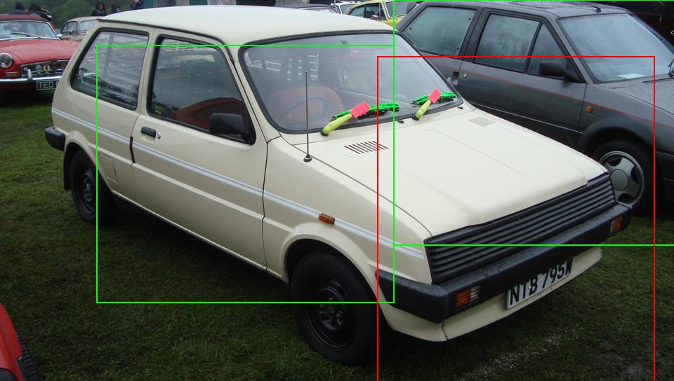

Can you share your training spec?
I remember that you only train for only one class “car”,right?
If yes, need to modify detectnet_v2_inference_kitti_tlt.txt accordingly.
I didn’t train the model, I downloaded the pretrained one TrafficCamNet | NVIDIA NGC
OK, I see.
For TrafficCamNet | NVIDIA NGC , there are four classes.
Car
Bicycle
Person
Roadsign
So you need to modify detectnet_v2_inference_kitti_tlt.txt accordingly.
Thank you very much the script really worked, but the results are pretty bad. I think the problem is my bad detectnet_v2_inference_kitti_tlt.txt setting. What do you think?
Is there some kind of manual or document in which it is written about each configuration parameter?
Can you share latest detectnet_v2_inference_kitti_tlt.txt ?
For inference spec setting, please refer to DetectNet_v2 — TAO Toolkit 3.22.05 documentation.
detectnet_v2_inference_kitti_tlt.txt (2.4 KB)
Can you share an example of the inferenced result?
Yes, sure
Please resize to 960x544 and retry.
I don’t feel much of a difference
Could you change to a larger threshold ?
Ok, I increased dbscan_confidence_threshold to 0.9 and dbscan_eps to 0.2
But I hoped that results will be better. I believe that it is not the limit.
For better result, need to retrain your own dataset.
TrafficCamNet v1.0 model was trained on a proprietary dataset with more than 3 million objects for car class. Most of the training dataset was collected and labeled in-house from several traffic cameras in a city in the US. The dataset also contains 40,000 images from a variety of dashcam to help with generalization and discrimination across classes. This content was chosen to improve accuracy of the object detection for images from a traffic cam at a traffic intersection.
Thanks a lot for your help
