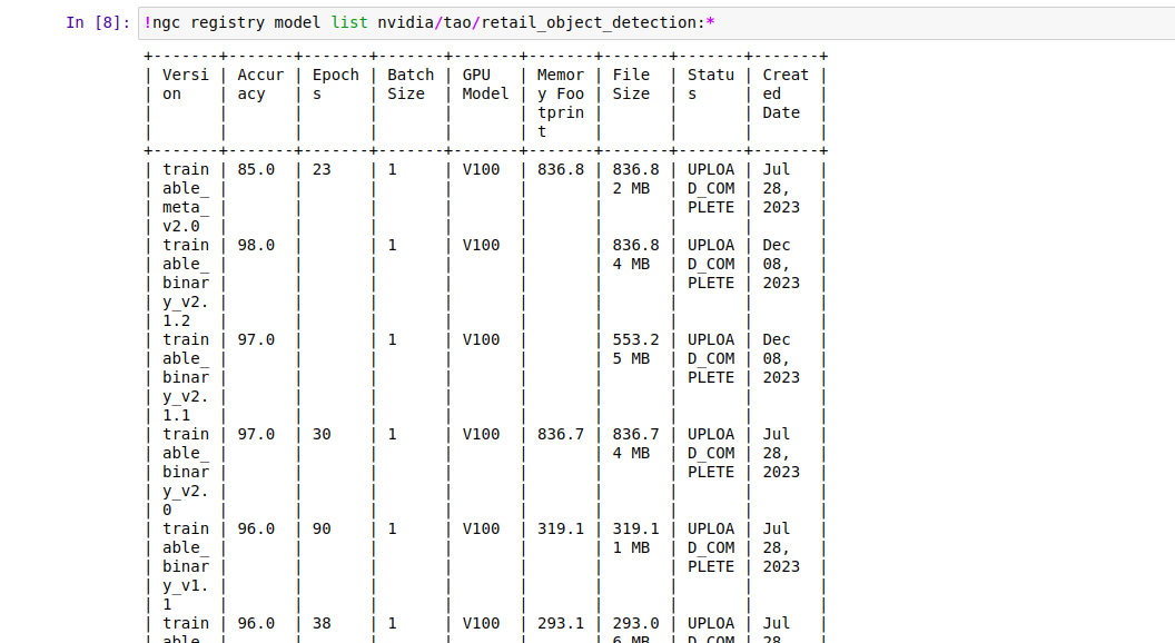

"$ tao model dino run /bin/bash” this command was run.
But now I have different problems. I run this command “dino train -e /home/doruk/doruk/getting_started_v5.3.0/notebooks/tao_launcher_starter_kit/retail_object_detection/specs/train.yaml results_dir=/home/doruk/doruk/getting_started_v5.3.0/notebooks/tao_launcher_starter_kit/retail_object_detection/retail_object_detection/results”. And File paths is right.
Result like below:
Then I tried in jupyter.
Please check the setting inside tao_mounts.json file.
The path of the train.yaml should be a path inside the docker.
An easy way to check is to open a terminal.
Then find the yaml file.

FileNotFoundError: [Errno 2] No such file or directory: '/home/doruk/doruk/getting_started_v5.3.0/notebooks/tao_launcher_starter_kit/retail_object_detection/retail_object_detection/models/retail_object_detection_vtrainable_binary_v2.1.2/retail_object_detection_binary_v2.1.2.pth'
Set the environment variable HYDRA_FULL_ERROR=1 for a complete stack trace.
Execution status: FAIL
What's next?
  Try Docker Debug for seamless, persistent debugging tools in any container or image → docker debug e2b0396e8deb579a57dadb7a5ee2821c5898145bdd462984f00ece7216b170a6
  Learn more at https://docs.docker.com/go/debug-cli/
2024-05-09 10:18:28,524 [TAO Toolkit] [INFO] nvidia_tao_cli.components.docker_handler.docker_handler 363: Stopping container.
But my .pth file’s path is
And train.yaml file

The path inside the docker is defined in “destination”.
Suggest you to set the same “source” and “destination” to ease your work.

First, I tried ‘retail_object_detection_binary_v2.1.2.pth’ but the Loss started at almost 80 and after 20 epochs the loss was still 20-25 . Then I tried ‘retail_object_detection_binary_v2.1.1.pth’ the loss started 17, after 8 epochs the loss became 5. But Training is so slow, 7-8 hours later almost 5 epochs is done.
May I know where did you download retail_object_detection_binary_v2.1.2.pth and retail_object_detection_binary_v2.1.1.pth ? Can you share the link?
The pretrained model is not trained by DINO network. So for DINO network, suggest to use the ones trained by DINO. See DINO | NVIDIA NGC,
or TAO Pretrained DINO with Foundational Model Backbone | NVIDIA NGC,
Pre-trained DINO ImageNet weights | NVIDIA NGC, Pre-trained DINO NvImageNet weights | NVIDIA NGC.
The reason I wanted to use TAO was because I would use the pth file of a model trained with retail dataset. Can I use this all .pth file for training by DINO network? Can’t I?
When I tried this DINO | NVIDIA NGC, I get this loss value.
OK, you can use the retail Object detection pretrained models.
