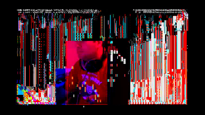

In Touchdesigner, I wrote some python code to generate rectangle masks of detected objects to display.
I used it as a part of live visuals for my album premiere livestream on Twitch at RGB Dog’s BedroomNightOut event: https://www.youtube.com/watch?v=hL9QXTFQdi4
