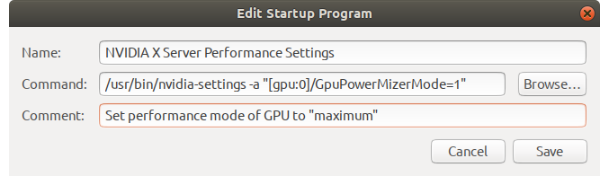

I’m here just to post an update. Limiting my GPU clock wasn’t able to stop the freezings. Setting the upper limit even lower (1100) also didn’t help, what made me exclude problems with my PSU. I came across this post yesterday and it caught my attention: someone was reporting a problem with NVIDIA’s adaptive mode. I tried the solution and today I didn’t experience any freeze. I also disabled GNOME’s notifications, but I don’t know if it has anything to do with this problem.
In case anyone looks for this post in the future, what seemed to have solved the problem for me was to put the following command on my startup applications (it changes the GPU performance level to full performance):
nvidia-settings -a [gpu:0]/GpuPowerMizerMode=1"
Screenshot from 2020-06-09 22-55-17
