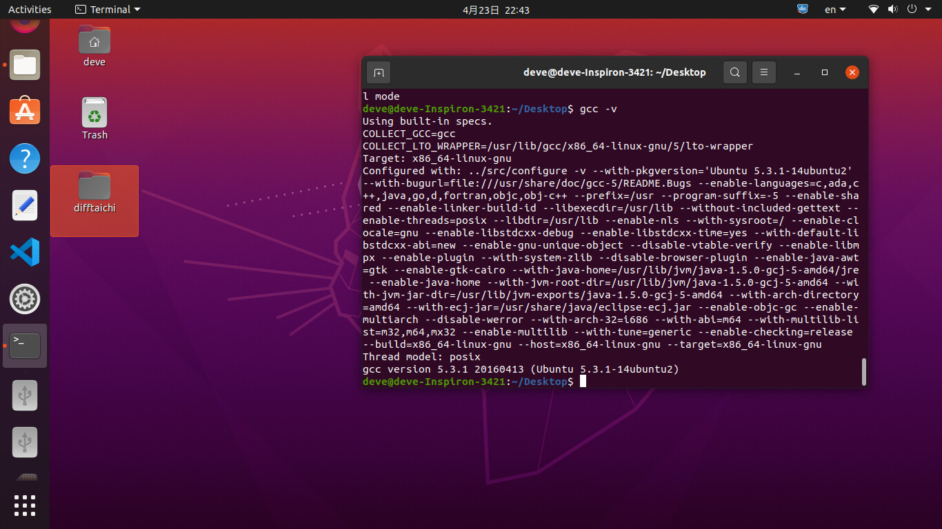

You have set gcc 5.3 as system compiler, thatâs why I said to change it back to the standard one, for the driver to compile.
Please use update-alternatives to set gcc and cc back to gcc-9.3
while when I build the examples from cuda8.0 and run it, it shows error: [cuda_driver.h:operator()@81] CUDA Error CUDA_ERROR_UNKNOW: unkown error while calling init(cuinit),and again I reinstall cuda8.0, it shows incomplete installation, the log file is up to date, plz check it.make.log (635.6 KB)
Itâs still set to gcc 5.3
Please post the output of
gcc -v
cc -v
make.log (6.7 KB)
hi, I run an cuda based example and the system throws an error, I logged the output into a log file, the screenshot shows an version of gcc
