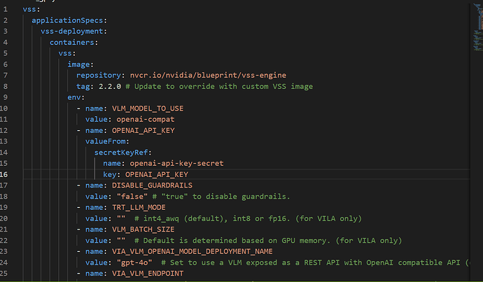

I have launchpad access with 8 NVIDIA H100 NVL GPUs. I am able to deploy and use VSS with nvila but unable to use gpt-4o model with VSS replacing nvila. I followed the instructions mentioned in Nvidia documentation( Configure the VLM Video Search and Summarization Agent). Attaching the images from overrides file which I have modified for using gpt-4o through openai azure api key.

Content of overrides file:
vss:
  applicationSpecs:
    vss-deployment:
      containers:
        vss:
          image:
            repository: nvcr.io/nvidia/blueprint/vss-engine
            tag: 2.2.0 # Update to override with custom VSS image
          env:
            - name: VLM_MODEL_TO_USE
              value: openai-compat
            - name: OPENAI_API_KEY
              valueFrom:
                secretKeyRef:
                  key: OPENAI_API_KEY
            - name: DISABLE_GUARDRAILS
              value: "false" # "true" to disable guardrails.
            - name: TRT_LLM_MODE
              value: ""  # int4_awq (default), int8 or fp16. (for VILA only)
            - name: VLM_BATCH_SIZE
              value: ""  # Default is determined based on GPU memory. (for VILA only)
            - name: VIA_VLM_OPENAI_MODEL_DEPLOYMENT_NAME
              value: "gpt-4o"  # Set to use a VLM exposed as a REST API with OpenAI compatible API (e.g. gpt-4o)
            - name: VIA_VLM_ENDPOINT
              value: "https://usncoai0kua.openai.azure.com"  # Default OpenAI API. Override to use a custom API
            - name: VIA_VLM_API_KEY
              value: "XXXXXXXXXXXXXXXXXXXXXXX"  # API key to set when calling VIA_VLM_ENDPOINT
            - name: OPENAI_API_VERSION
              value: "2024-05-01-preview"
            - name: AZURE_OPENAI_API_VERSION
            - name: AZURE_OPENAI_ENDPOINT
  resources:
    limits:
      nvidia.com/gpu: 2   # Set to 8 for 2 x 8H100 node deployment
  # nodeSelector:
  #   kubernetes.io/hostname: <node-1>
nim-llm:
  resources:
    limits:
      nvidia.com/gpu: 4
  # nodeSelector:
  #   kubernetes.io/hostname: <node-2>
nemo-embedding:
  resources:
    limits:
      nvidia.com/gpu: 1  # Set to 2 for 2 x 8H100 node deployment
  # nodeSelector:
nemo-rerank:
  resources:
    limits:
  # nodeSelector:

Could you refer to our FAQ and attach the detailed log information?
Attached detailed logs for all pods which are not running
  Warning  FailedMount  2m10s (x2177 over 3d1h)  kubelet  MountVolume.SetUp failed for volume "secret-ngc-api-key-volume" : secret "ngc-api-key-secret" not found
Have you created the ngc-api-key-secret secret?
Yes, I have created and used the NGC API KEY for deploying VSS with Nvila. I am able to deploy that successfully but when changing the model to gpt-4o then it’s failed to deploy.

From the image you attached, there is no ngc-api-key-secret in your vsstest namespace.
Thanks for notifying that. It solved the error while deploying the services. Now I am able to access UI but when I am trying to use summarization API getting below error:
