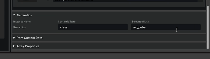

did you add a class for the prim in the Semantics Schema editor?

yep, i assume its this?
