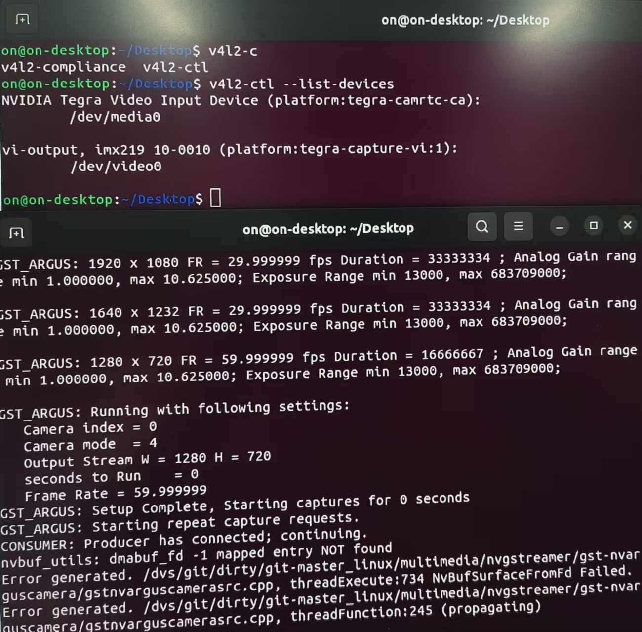

你好,我们在使用jetson orin nano 模块,jetpack6.1,自己设计的kit,有一个摄像头(imx219)打不开,开机后也能识别到/dev/video,另一个可以正常打开的。使用nvgstcapture-1.0输出的错误如下图所示:

Check the HW by v4l2-ctl command.
v4l2-ctl --stream-mmap -c bypass_mode=0
这个命令会一直阻塞,另外[gst-launch-1.0 nvarguscamerasrc ! ‘video/x-raw(memory:NVMM), width=1280, height=720, framerate=60/1’ ! nvvidconv ! xvimagesink sync=false]这个命令一样打不开摄像头。使用nvgstcapture-1.0 报出的错误:Error generated. /dvs/git/dirty/git-master_linux/multimedia/nvgstreamer/gst-nvarguscamera/gstnvarguscamerasrc.cpp, execute:805 Failed to create CaptureSession 谢谢!
Get the trace log to check.
sudo su
modprobe rtcpu_debug
echo 1 > /sys/kernel/debug/tracing/tracing_on
echo 30720 > /sys/kernel/debug/tracing/buffer_size_kb
echo 1 > /sys/kernel/debug/tracing/events/tegra_rtcpu/enable
echo 1 > /sys/kernel/debug/tracing/events/freertos/enable
echo 3 > /sys/kernel/debug/camrtc/log-level
echo 1 > /sys/kernel/debug/tracing/events/camera_common/enable
echo > /sys/kernel/debug/tracing/trace
cat /sys/kernel/debug/tracing/trace

Doesn’t looks like receive any validate data from the sensor.
Suppose it could be HW or cable problem.
硬件应该没有问题的,因为我将系统换成jetpack5.1.2的是可以显示画面的。
Please dump the device tree to compare with JP5.
