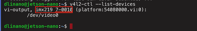

What’s the below command show.
v4l2-ctl --list-devices
Install the v4l-utils first.
sudo apt-get install v4l-utils
The first line for device at 7-0010
imx219 7-0010: tegracam sensor driver:imx219_v2.0.6
is not followed by an error message. This camera has been successuflly probed and can be used.
The next lines with device at 8-0010 show that probing that device failed. This is normal if you have only one camera connected in CSI0 connector.

The camera in port CAM0 is connected with Raspberry Pi Camera v2 and previously it worked. For any reason, i does not work now. The result of v4l2-ctl --list-devices is:
vi-output, imx219 7-0010 (platform:54080000.vi:0):
	/dev/video0
And the return of v4l2-ctl --all is:

                   sensor_modes 0x009a2082 (int)    : min=0 max=30 step=1 default=30 value=6 flags=read-only
I tried too with another flex cable and with another Raspberry Pi Camera v2 and the result is the same.
I appreciate any help. Thanks
You may check this post.
check this
