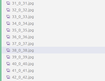

@Fiona.Chen, I tried with other streams as well but same result. I noticed a pattern in the image files being generated:
Here’s the code that generates the file:
DsExampleOutput *DsExampleProcess(ImageData *image_data, NvDsFrameMeta* frame_meta)
    if(image_data->cvmat) {
        static unsigned int count = 0;
        cv::imwrite(std::to_string(frame_meta->frame_num) + "_" + std::to_string(frame_meta->source_id) + "_"  + std::to_string(count) + ".jpg", *(image_data->cvmat));
        count++;
with counter incrementing on every loop and frame_num being passed by respective stream meta (there are 3 running simultaneously), I was expecting count to surpass frame_num, in multiple of 3 at some point. But that never happened.
Now, I feel like there’s some serious error during pipeline setup. @Fiona.Chen do you also find this erroneous ?
