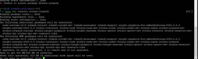

TensorRT should be pre-installed with the SDK Manager by default.
If not, you can also install via the commands below:
$ sudo apt install nvidia-jetpack

I installed the Jetson 6.2.1 sources onto an NVMe drive using the SDK Manager.
Ollama runs natively. I can start llama3.2:4b, but only after clearing the RAM cache.
