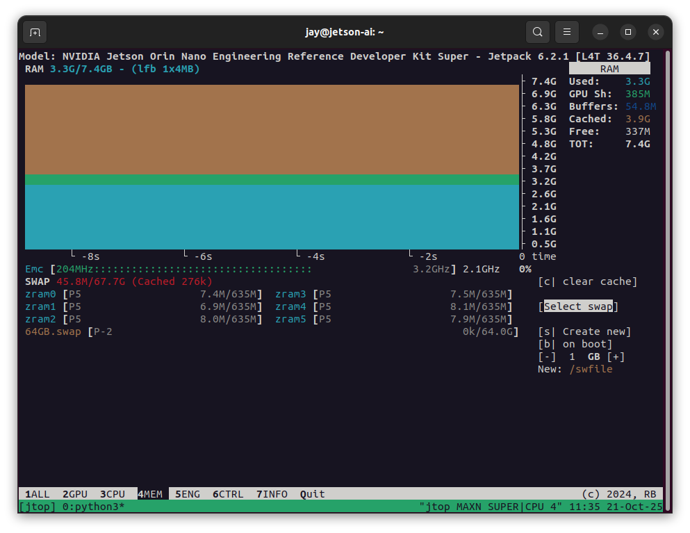

Could you try to run a simple CUDA sample (ex, deviceQuery) to check the GPU functionality first?
I git clone the repo, but the cuda compiler is not installed on the host. I have been building inside the docker, so would try this method.
ollama
total used free shared buff/cache available
Mem: 7802584 2649992 234220 117504 4918372 4796784
Swap: 3901272 81920 3819352

CUDA compile is located at /usr/local/cuda-12.6/bin.
Please try to set up the environment parameter with the comments below and try it again.
$ export PATH=/usr/local/cuda-12.6/bin:$PATH
$ export LD_LIBRARY_PATH=/usr/local/cuda-12.6/lib64:$LD_LIBRARY_PATH
Just want to confirm that the ‘upgrade’ you mean here is from default r36.4.4 to r36.4.7?

I wonder if rollback the nvidia-l4t-firmware:arm64 package to version 36.4.4-20250616085344 from 36.4.7-20250918154033 would help?
I have not tried, but seems there are some folks that have explored this option.
Of course one runs the risk of an finding the jetson in unrecoverable state.

I tried to run those commands, but same result as before.
Also here is the jtop memory status image.
