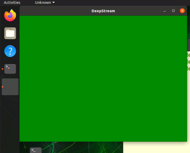

I want to use deepstream for my yolov5. Although I have read several docs and the same problem in Deepstream-test5 for usb camera fail - Intelligent Video Analytics / DeepStream SDK - NVIDIA Developer Forums
I still have a green screen (below).

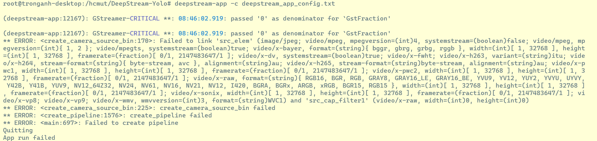

I have seturi=v4l2:///dev/video0 , but it still does not work

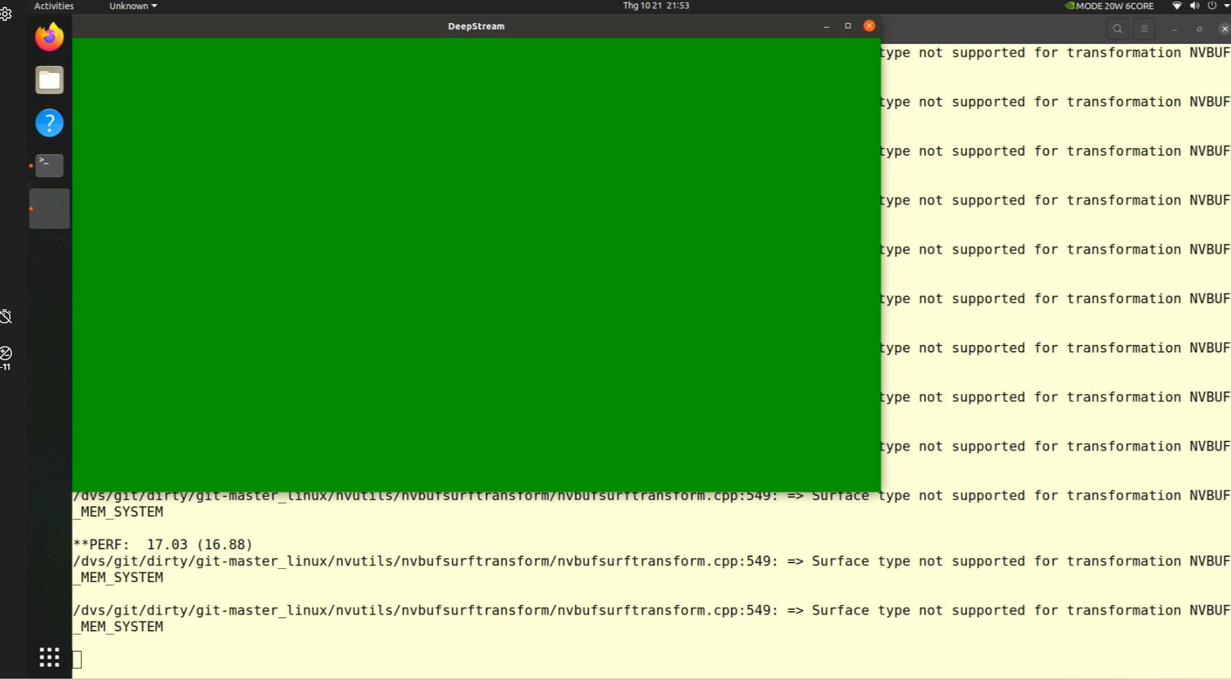

I try this command but it still not work. Its output is Preformatted text/dvs/git/dirty/git-master_linux/nvutils/nvbufsurftransform/nvbufsurftransform.cpp:549: => Surface type not supported for transformation NVBUF_MEM_SYSTEM
However, the signal light of webcam turn on

When I change to nvvidconv, nothing popup although the camera signal is turned on.
And the output is like this

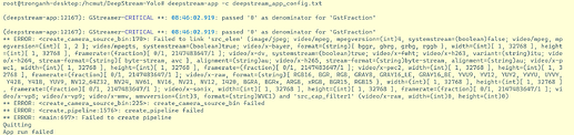

When I change type=2 and set uri=v4l2:///dev/video0, the output is like that

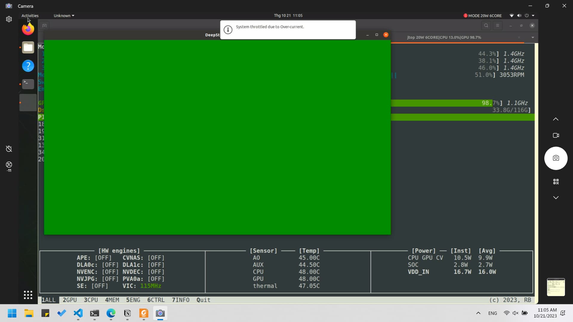

When I set type=1 and have enough key such as
camera-v4l2-dev-node=0
camera-width=640
camera-height=480
camera-fps-n=30
camera-fps-d=1
The output is just a green screen:

I have tried and it still doesn’t work well. Just a green screen popup

Have you flashed your os when you update the DeepStream to 6.3? You need to use the JetPack 5.1.2. https://docs.nvidia.com/metropolis/deepstream/dev-guide/text/DS_Quickstart.html#id5
Oh, my bad.
The reason for issue above may be the conflict of version between Deepstream 6.3 and Jetpack 5.1
I have re-installed Deepstream 6.2 ( or could update Jetpack to 5.1.2) and everything has worked.
