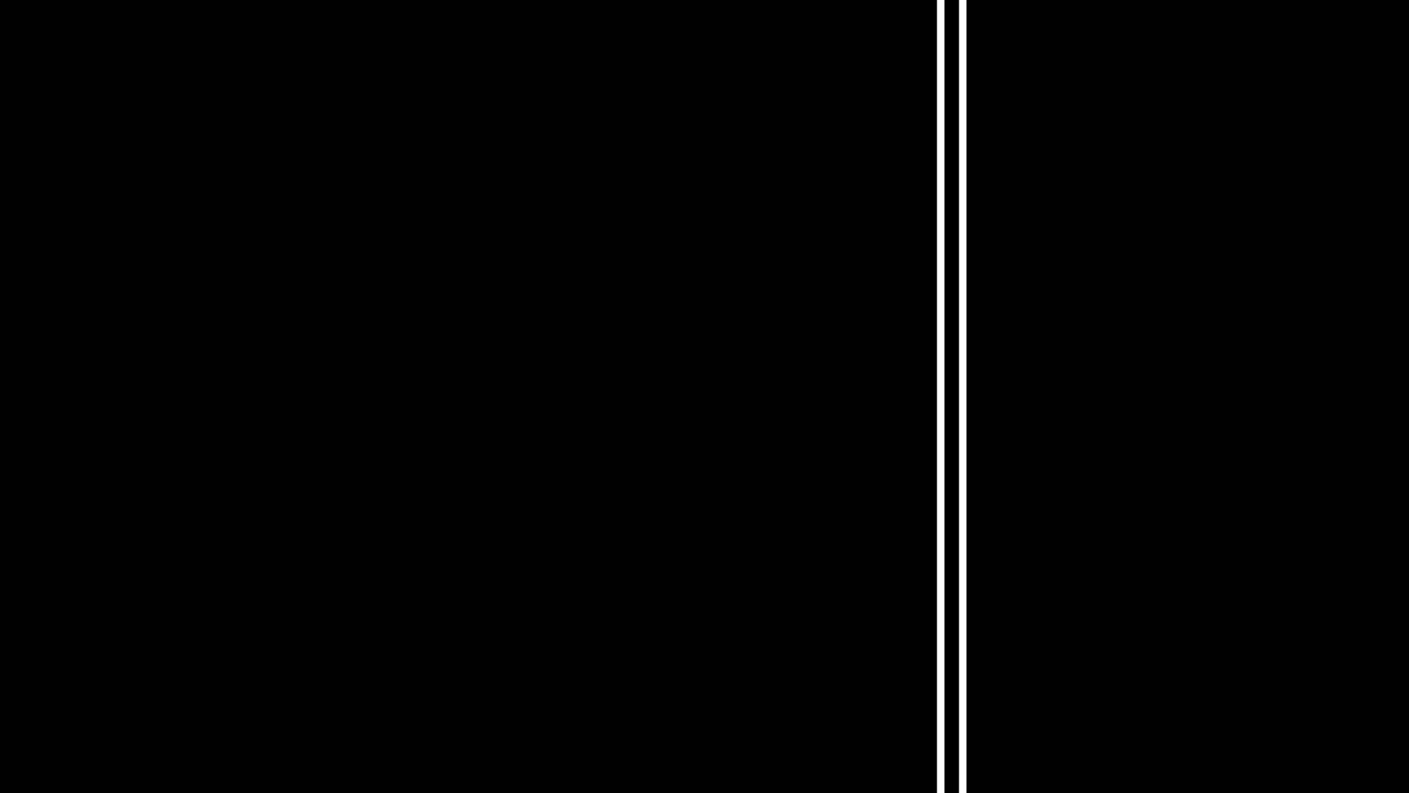

Video/desktop tearing again with settings which are meant to eliminate it (Fermi/Kepler/Maxwell)
I don’t want to revive the old topic because it grew out of proportions and contains far too many messages to cope with, so, here’s the new one.
Here’s a new video which demonstrates that under the newest NVIDIA drivers tearing under non-compositing window managers is back again:
Here’s my X.org settings:

It’s the TripleBuffer option doing it. Turning that off fixed it for me.
I don’t know exactly what driver release broke it, though.
I have turned it off here and while there’s less tearing in Firefox, Google Chrome still exhibits huge tearing.
Edit: ForceFullCompositionPipeline doesn’t help either.
