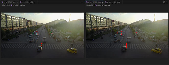

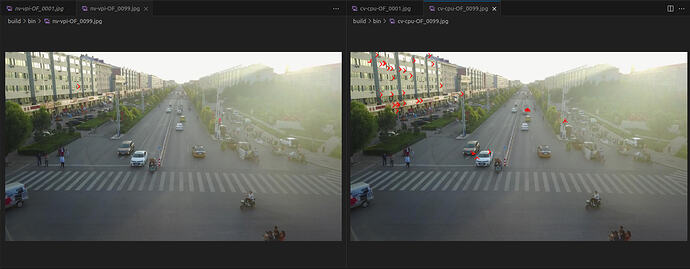

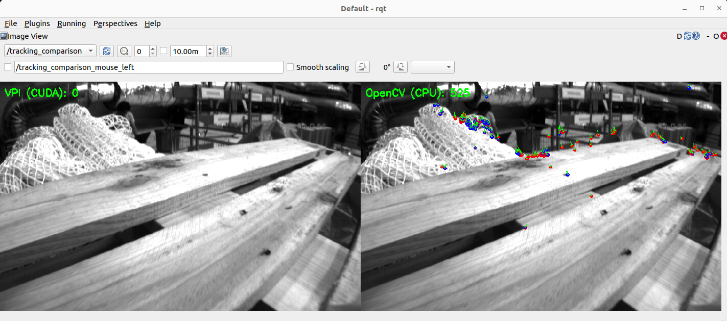

I tried implementation a ROS2 node following the VPI3.2 sample for Sparse LK Optical Flow,
I found that the first few frames of tracking always produce good results but subsequently all fail miserably.
Initially i tried swapping the pyramids, or even regenerating the pyramids each frames but it is still the same. I had tried logging the hash of the inputs (prevPyr, curPyr, prevPts) to the vpiSubmitOpticalFlowPyrLK and it is valid. Changing between CPU and CUDA backend does not work.
Afterwards, I tried comparing with OpenCV side by side with the same input.
These are the observations
Is there any place I should look out for, I don’t think there is any data corruption issue.
Following is the code.
