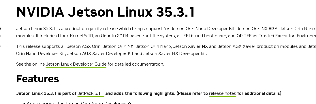

Is this a custom board or NV devkit? Which Jetpack release is that?
R35 (release), REVISION: 4.1, GCID: 33958178, BOARD: t186ref, EABI: aarch64, DATE: Tue Aug 1 19:57:35 UTC 2023

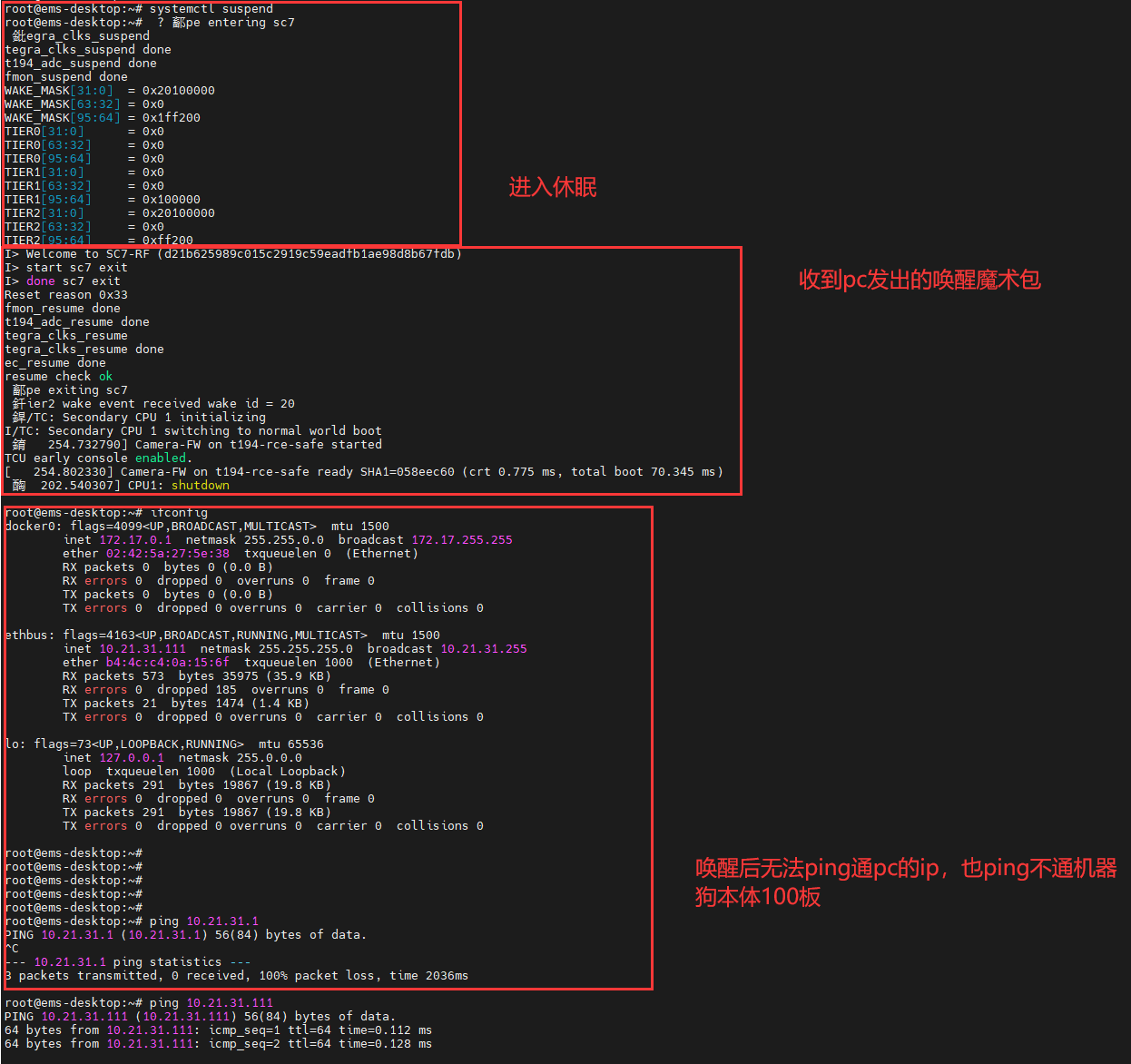

The first suspend and wake-up prints the following, but the network does not work properly. After running ifconfig ethbus down; ifconfig ethbus up, the network functions normally.

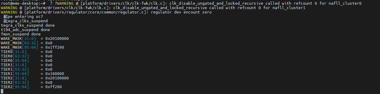

The second suspend reports a warning with the following information and then cannot be woken up again.
