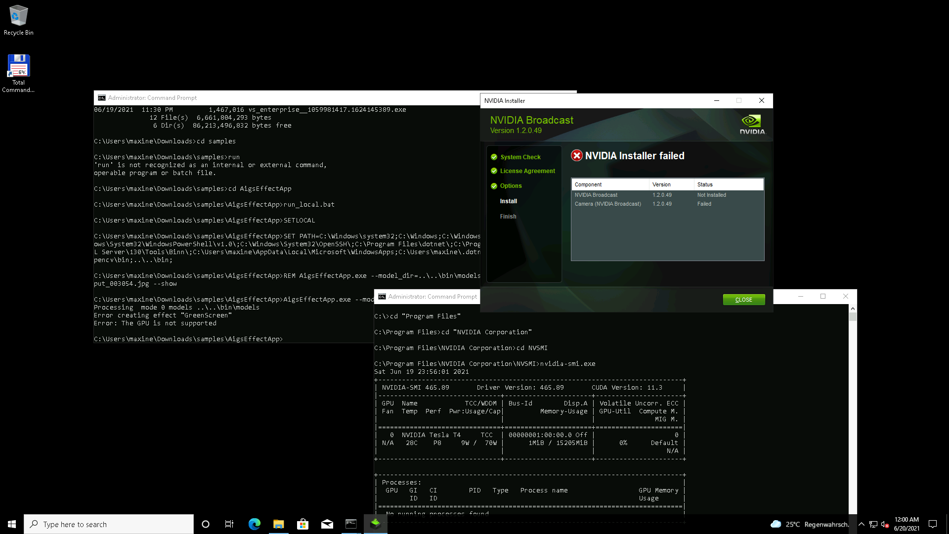

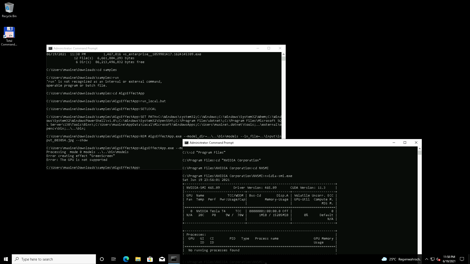

@jkrinitt we can not install broadcast app on Windows 10 Pro with T4;
is that particular envirnment not supported? for the broadcast app? for video sdk? for both? neither of the two?
this one is Quadro RTX solutionu by Nvidia offered at Google Cloud

Thank you for trying out NVIDIA Maxine Audio SDK. Unfortunately, Maxine SDKs donāt work on Pascal architecture. Iād encourage you to try running the SDK on either of these hardware platforms: V100, T4, A10, A100, A30. Maxine SDK docker containers are now available with pre-packaged dependencies which are much more convenient to pull from NGC and run on your cloud instance. For Maxine Audio SDK, please check this link and download the containers from NGC. Let me know if this helps thanks!
