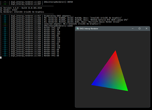

I’ve run into a challenging issue while implementing DirectX11-OpenGL interoperability, and was hoping to get some advice.
Objective:
My goal is to use the WGL_NV_DX_Interop2 extension to use a texture rendered in OpenGL directly within DirectX11, without any additional memory copies.
The Problem:
Despite using the exact same code, the result from glCheckFramebufferStatus changes depending on which GPU is active.
System Environment:
OS: Win11 x64 24H2 (Build Version: 26100.4652)
Intel GPU: Intel(R) Iris(R) Xe Graphics (Core i9-13900H CPU)
NVIDIA GPU: NVIDIA GeForce RTX 4070 Laptop GPU
NVIDIA Driver Version: 577.00
1. Success Case (Intel(R) Iris(R) Xe Graphics GPU):
  • When the application runs on the default Intel GPU, the entire process works perfectly.
    (A rotating RGB triangle is displayed, as shown below:)
2. Failure Case (NVIDIA GeForce RTX 4070 Laptop GPU):
  • I’ve forced the application to use my discrete RTX 4070 Laptop GPU via NvOptimusEnablement.
  • In this case, after attaching the shared DirectX interop texture to the OpenGL Framebuffer, glCheckFramebufferStatus returns GL_FRAMEBUFFER_UNSUPPORTED (0x8CDD).
My Question:
Is this likely a logical error in my code? Or is it possible that support for the WGL_NV_DX_Interop2 extension has changed, or that there’s a known compatibility issue with modern NVIDIA GPUs and their drivers?
A minimal, reproducible example is attached below for testing.
I would greatly appreciate any advice, especially if you have had a similar experience or have ideas for a solution.
Thank you!
