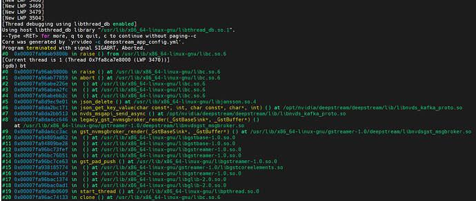

I used the gdb tools to check the details, and got the following informations:
I seems the error was caused by the message?

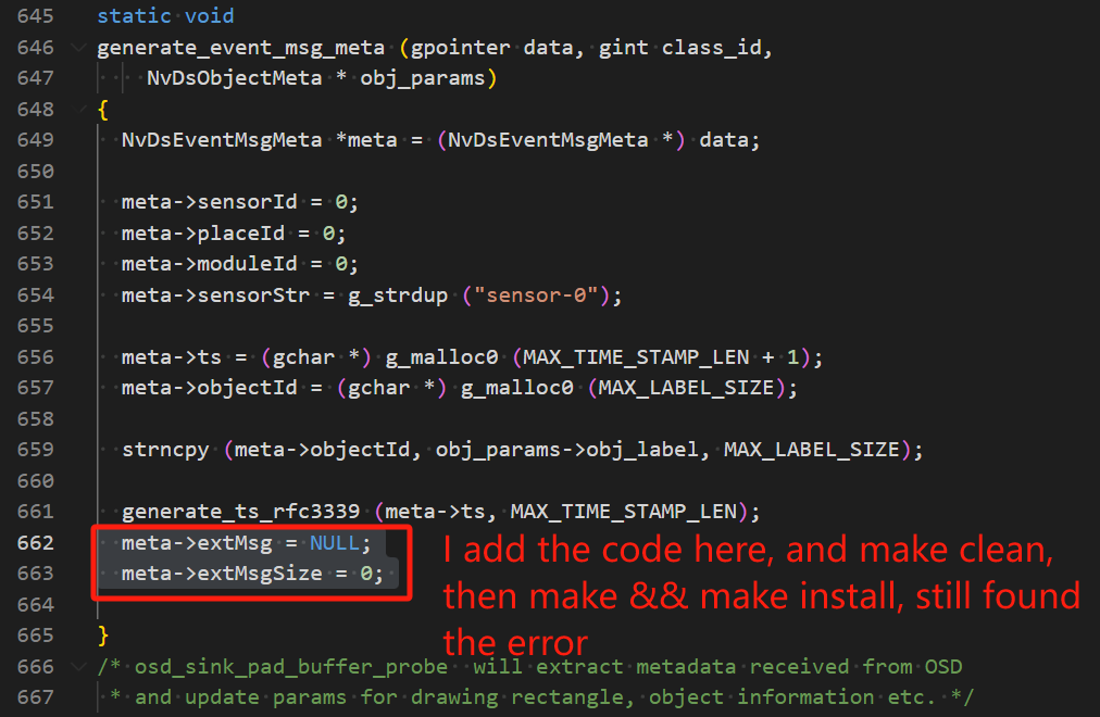

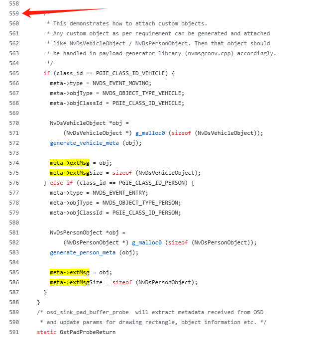

I think it may be related to the part of code you deleted. Try adding initialization code in generate_event_msg_meta
meta->extMsg = NULL;
meta->extMsgSize = 0;
Thanks for your reply.

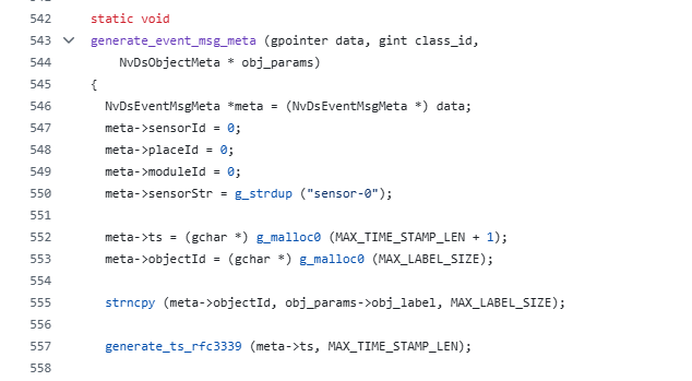

I checked the original code of generate_event_msg_meta, it seems do not contain these two lines:
And I also add the code as your suggest, still have same error.
It is abnormal that I use same code on Jetson Xaiver nx board, it can work fine…But got invalid pointer on x86 GPU platform.

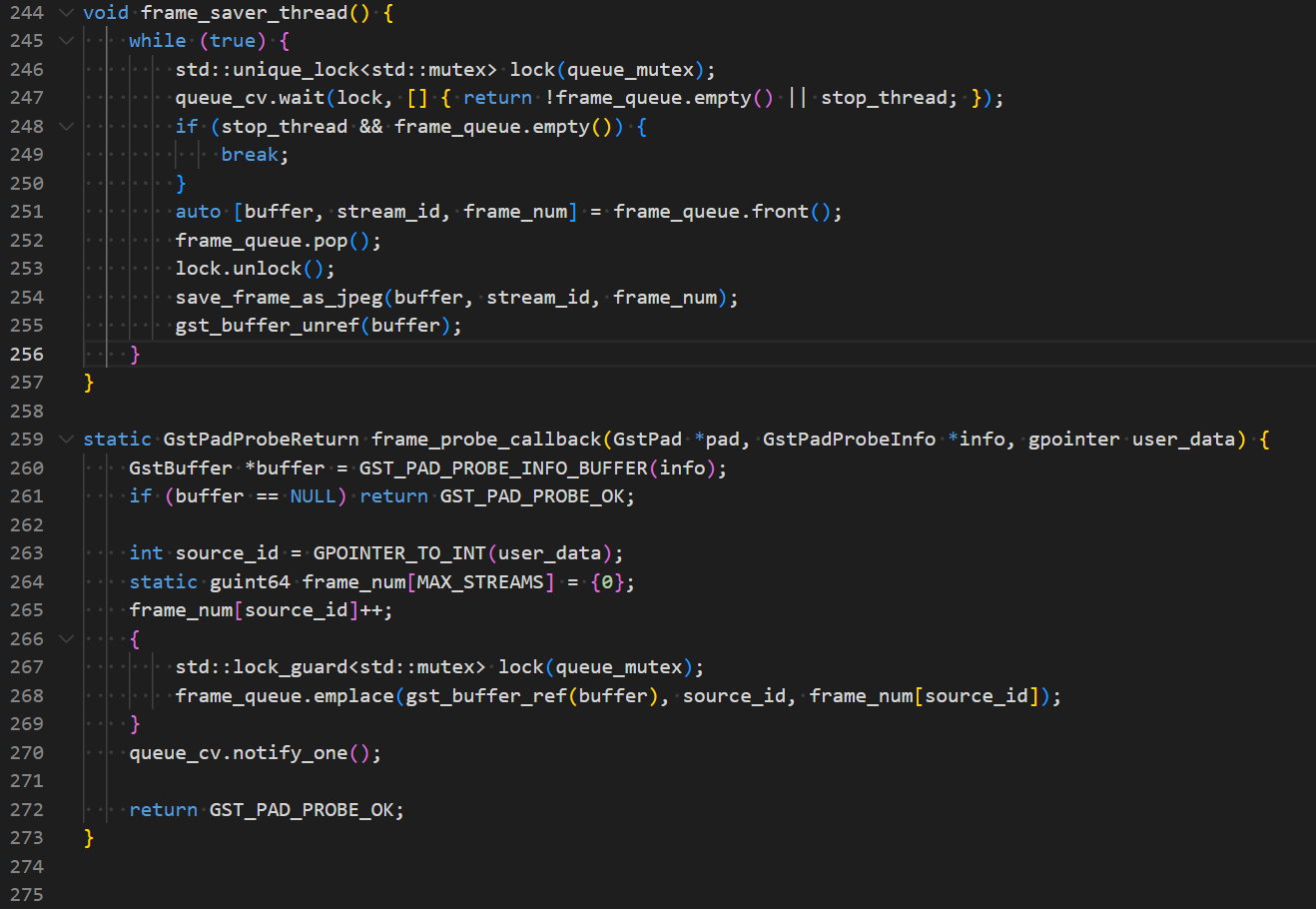

  1. I add the func of save_frame_as_jpeg to save each frame when decoding from the video stream for further usage; — the func would be activated with independent save_thread shown as below:

1.If you want to save a frame or object, using nvds_obj_enc_process is recommended. This does not require the use of opencv and copies the data to the CPU, which has better performance.
The complete example is at:
/opt/nvidia/deepstream/deepstream/sources/apps/sample_apps/deepstream-image-meta-test/deepstream_image_meta_test.c
2.Is the stack for each crash consistent?
You can recompile libnvds_kafka_proto.so and use the symbol library to debug the problem.

  1. For the saving frame, It seems to be set at the stage of osd_sink_pad_buffer_probe. Is it possible to save the decode frame for each source? I think I had tested before and got a mix-picture of sources? I want to save every frame for each source for further usage.
  2. For the crash, I debug each core file, it seems the same reason shown before. I feel confused that why the same code can be run sucessfully on Jetson NX board, but got the error at X86 GPU?
nvds_obj_enc_process can save each frame in the batch as an image, so as long as you save it downstream of nvstreammux, it will be OK

I’m a greenhand. Is there any demo that I can check how to save the decode frame fom nvstreammux for each source independently?
I just test the code on DS-7.1, it seems some plugins changed, which cause more errors… such as file of libnvparsers.so not found …
Add a probe function to the nvstreammux src pad, and then use nvds_obj_enc_process to save all frames in the batch as images.
/opt/nvidia/deepstream/deepstream/sources/apps/sample_apps/deepstream-image-meta-test/deepstream_image_meta_test.c is a complete example
