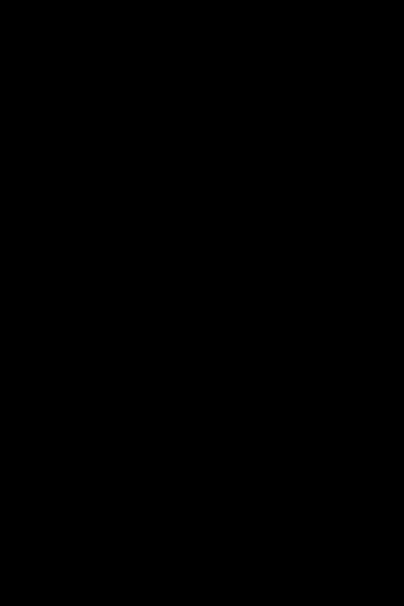

Then, I run following your file and I got this image result .
  • This is my pipeline when I run your file. I think you can help me check from this too.
    [I update the pipeline in below comment]

Repro the issue, checking internally, will feedback if progress.
Please let me know when you have an answer for that, thank you
I tried your config, enable tracker, then the issue gone. please try on your side.
Thank you @Amycao for your reply,
I miss saving actually also I change the tracker but it still not work when I enable tracker and change the gpu-id from 0 to 1
Update
This is my current config after change follow your help but the image still return black. Can you point out what you change more in source code or in where.

I used this config file, tmp.txt (5.2 KB)
after enable tracker in the config, saved image black issue gone. please find which part caused the issue one by one on your side.
[tracker]
enable=1
Thank you @Amycao for your reply, After using your config. I meet this problem as below
0:00:02.669697196 18246 0x560b387ee370 WARN          nvvideoconvert gstnvvideoconvert.c:3000:gst_nvvideoconvert_transform:<sink_sub_bin_transform3> error: Memory Compatibility Error:Input surface gpu-id doesnt match with configured gpu-id for element, please allocate input using unified memory, or use same gpu-ids OR, if same gpu-ids are used ensure appropriate Cuda memories are used
0:00:02.669739969 18246 0x560b387ee370 WARN          nvvideoconvert gstnvvideoconvert.c:3000:gst_nvvideoconvert_transform:<sink_sub_bin_transform3> error: surface-gpu-id=1,sink_sub_bin_transform3-gpu-id=0
0:00:02.669817478 18246 0x560b387ee370 ERROR         nvvideoconvert gstnvvideoconvert.c:3387:gst_nvvideoconvert_transform: buffer transform failed
ERROR from sink_sub_bin_transform3: Memory Compatibility Error:Input surface gpu-id doesnt match with configured gpu-id for element, please allocate input using unified memory, or use same gpu-ids OR, if same gpu-ids are used ensure appropriate Cuda memories are used
Debug info: gstnvvideoconvert.c(3000): gst_nvvideoconvert_transform (): /GstPipeline:pipeline/GstBin:processing_bin_0/GstBin:sink_bin/GstBin:sink_sub_bin3/Gstnvvideoconvert:sink_sub_bin_transform3:
So I change the to
nvbuf-memory-type=3. It can solved the problem.
But I still cannot saving the image only black image is saving. Also since I only had 2 gpus. So I set
gpu-id=1 instead of gpu-id=2
this problem also happen when I change it on deepstream-transfer-learning-test and it’s also cannot work when I change like your config.

when I setup like this, the image will be save with black image like in deepstream-test5. everything in source code, I still keep as origin. So I guess this not cause due to the config or source code file. I guess it maybe come from GPU problem. do I right
Yes, you need to change GPU ID accordingly, since i have 3 GPU in my system.
Did you just change GPU ID to another GPU in configuration, other untouched which will cause the issue, right? but your GPUs are 2 RTX 3080, same GPU, different result, does not make sense.
hi @Amycao,
I so not sure what happened but I already checked everything on my setup. The error only happened when I change the GPU id. actually from GPU 0 to GPU 1. I also checked GPU usage when using both. it’s also running when I changed but saving images still not work when I used the second GPU. If you need me to provide any information I will upgrade here for you
