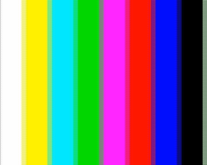

Why v4l2-ctl returns corrupted image (odd rows shifted), but nvargus_nvraw works OK?
I am running
nvargus_nvraw --c 0 --exp0 “0.016666,1” --file out --format “raw,jpg”
and it returns perfect image, but
v4l2-ctl -d /dev/video0 --set-ctrl bypass_mode=0 --stream-mmap --stream-count=1 --stream-to test.raw --verbose
returns image with good even bayer rows (0, 2, etc) except the last 16 samples are missing
and odd rows (1,3,etc) appear to be shifted left, as if the last 16 samples of even rows were moved to the next row.
My image is 720x720 10 bit bggr.
Note that occasionally I see “General error queue is out of sync with frame queue” error, but in most tests there are no errors, but image is corrupt every time.
I tried changing parameters in dts: mclk_khz, pix_clk_hz, line_length, but they make no difference.
Are there some other secret settings, which nvargus_nvraw sets, but v4l2-ctl does not?
Thank you
It could be the 64 alignment problem. Try v4l2-ctl --preferred_stride=1472

Hi @jhnlmn
The NVIDIA Jetson capture systems seem to have a 64 byte alignment, so there’s a limitation with the number of bytes-per-line (width * bytes) that are not divisible by 64, which it’s required to add an stride aliment to visualize the image correctly.
You can find more information in this wiki:
https://developer.ridgerun.com/wiki/index.php/NVIDIA_Jetson_VI_Stride_Alignment#Changes_on_Stride_Alignment
According to the document:
bytes: 2
bytes per line: 720 * 2 = 1440
# Not Divisible by 64
1440 / 64 = 22,5
# Stride is added to increase the bytes per line
fixed bytes per line: 23 * 64 = 1472
fixed width: 1472 / 2 = 736
# Total size of the image
736 * 720 * 2 = 105984
I haven’t tested the preferred_stride v4l2 control, but I belive it should work too.

preferred_stride=1472 works OK for sensor 720x720:
v4l2-ctl -d /dev/video0 --set-ctrl bypass_mode=0 --set-ctrl preferred_stride=1472 --stream-mmap --stream-count=1 --stream-to test.raw --verbose
Is there any advantage in redefining TEGRA_STRIDE_ALIGNMENT as NVIDIA Jetson VI Stride Alignment - RidgeRun Developer Wiki suggests?
