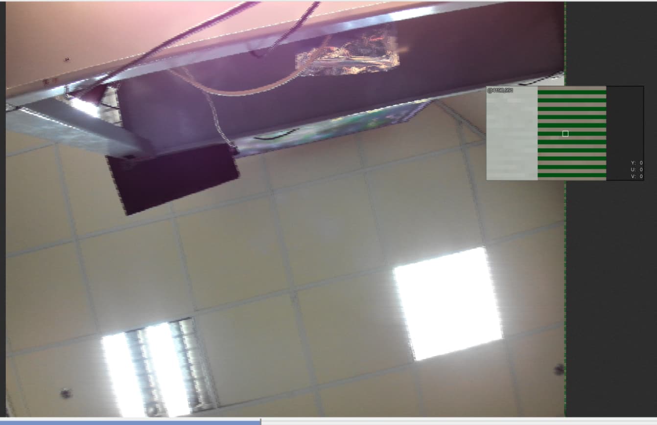

But at 13mp(4208x3120) we get quality issues. It seems like every second row is offset by 16 pixels, it is noticeable around edges and there is a green line 16 pixel wide(missing pixels) at the right border:

Here is a raw image captured using v4l2-ctl method.
4208x3120.yuv (25.0 MB)
At the end of every second line there are 16 pixels all set to zero.

Regarding our main issue with images with less than 640 pixels per line: even if we solve the issue by adding 240 pixels to our 400 pixels lines, it’s not an elegant way to solve the problem. I would like to give you another information. Even if the streaming was working with v4l2-ctl, we had an issue with the pixels in the images: the odd lines were OK, but for the even lines were shifted by 16 pix…
It seems to be a problem with alignment but I can’t find any info on what the constrain is.

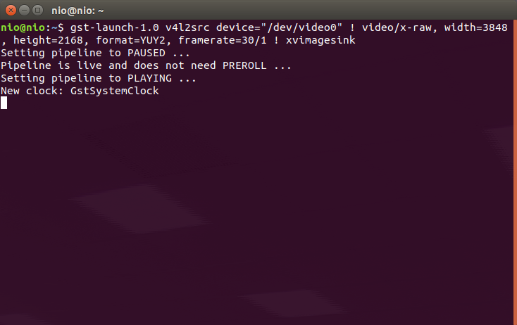

I am trying to capture video from a 3848 2168 YUV422 (YUY2) GMSL2 camera on Xavier.
When using another 3840 2160 resolution GMSL2 camera sensor, everything works just as fine, I can get the correct image and data. However when I change to a new 3848*2168 YUY2 GMSL2 camera (after updating necessary kernel drivers), I get distorted image from v4l2src through:
gst-launch-1.0 v4l2src device=“/dev/video0” ! video/x-raw, width=3848, height=2168, format=YUY2, framerate=30/1 ! xvimagesink
[Sc…
