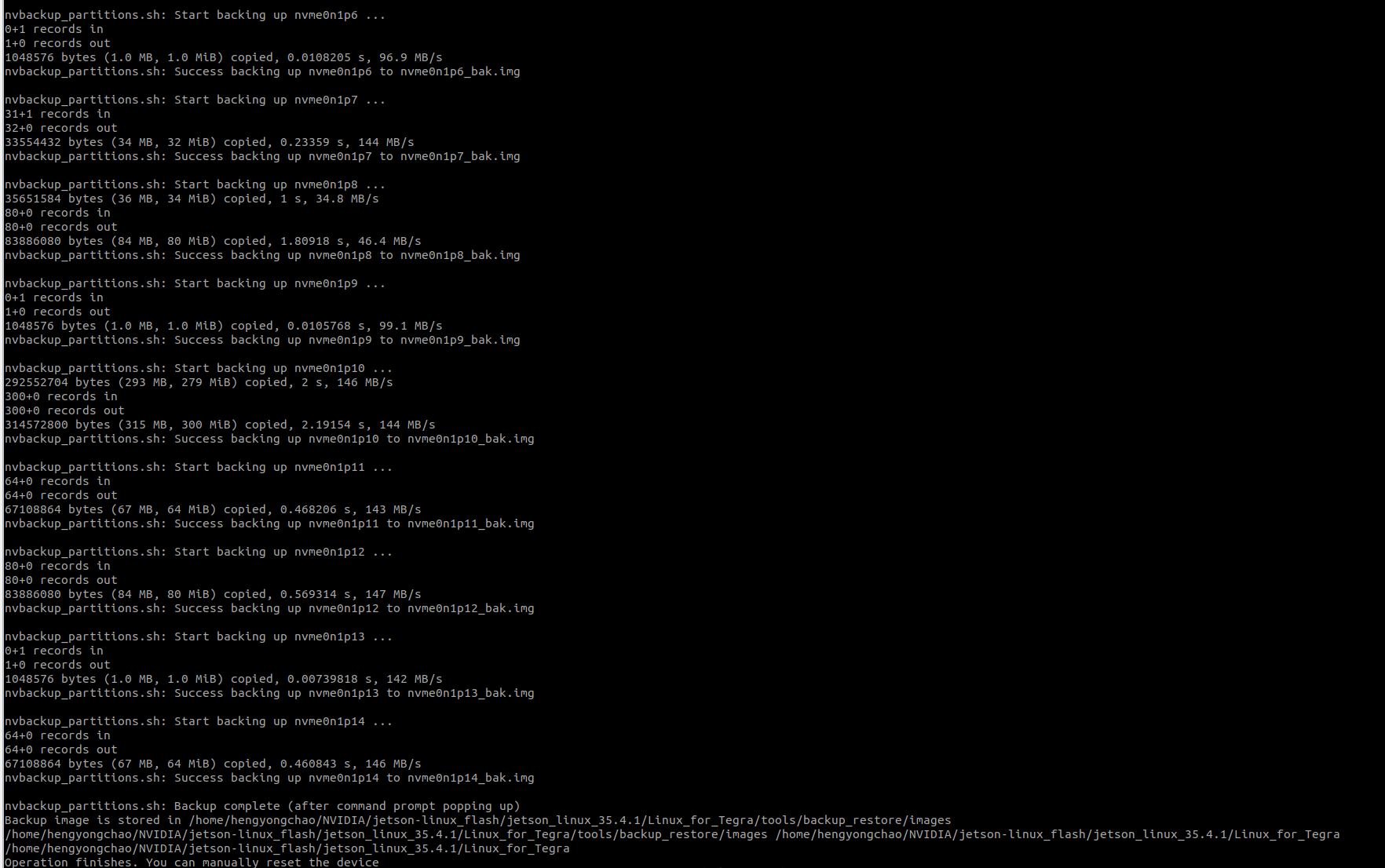

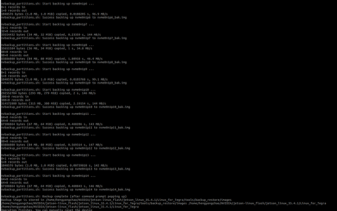

I try to use Linux_for_Tegra/tools/README_backup_restore.txt to make a massflash backup image.
Workflow 1: To create a backup image to host storage, this step is works good.
sudo ./tools/backup_restore/l4t_backup_restore.sh -e nvme0n1 -b jetson-orin-nano-devkit

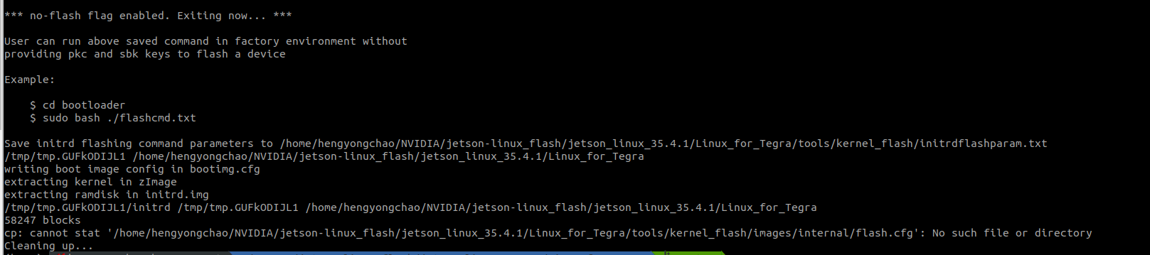

sudo ./tools/kernel_flash/l4t_initrd_flash.sh --use-backup-image --no-flash --network usb0 --massflash 5 --showlogs jetson-orin-nano-devkit mmcblk0p1
Got issue on this step.
*** no-flash flag enabled. Exiting now… ***
User can run above saved command in factory environment without
providing pkc and sbk keys to flash a device
Example:
$ cd bootloader
$ sudo bash ./flashcmd.txt
Save initrd flashing command parameters to /home/hengyongchao/NVIDIA/jetson-linux_flash/jetson_linux_35.4.1/Linux_for_Tegra/tools/kernel_flash/initrdflashparam.txt
/tmp/tmp.YyGRVsAELG /home/hengyongchao/NVIDIA/jetson-linux_flash/jetson_linux_35.4.1/Linux_for_Tegra
writing boot image config in bootimg.cfg
extracting kernel in zImage
extracting ramdisk in initrd.img
/tmp/tmp.YyGRVsAELG/initrd /tmp/tmp.YyGRVsAELG /home/hengyongchao/NVIDIA/jetson-linux_flash/jetson_linux_35.4.1/Linux_for_Tegra
58247 blocks
cp: cannot stat ‘/home/hengyongchao/NVIDIA/jetson-linux_flash/jetson_linux_35.4.1/Linux_for_Tegra/tools/kernel_flash/images/internal/flash.cfg’: No such file or directory
Cleaning up…
step2 full log here.
Workflow3-command_2.txt (85.4 KB)

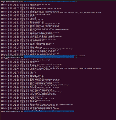

Is it operated under the same BSP folder with which the module is flashed?
What do you have under Linux_for_Tegra/tools/kernel_flash/images/internal/ and Linux_for_Tegra/tools/kernel_flash/images/external?
Hi @DaveYYY
1.Linux_for_Tegra/tools/kernel_flash/images/internal/ 2.Linux_for_Tegra/tools/kernel_flash/images/external

The log says it’s run under ~/NVIDIA/jetson-linux_flash/jetson_linux_35.4.1/Linux_for_Tegra, but your screenshot says ~/NVIDIA/Linux_for_Tegra_mass_flash, so which one is correct?
Can you please confirm this?
I just don’t know what you are doing here.
Hi @DaveYYY
Linux_for_Tegra_mass_flash and jetson-linux_flash/jetson_linux_35.4.1/Linux_for_Tegra were both tried.
Linux_for_Tegra_mass_flash is oringl form NVIDIA, nothing changed.
It just for test the offical dev board.
jetson-linux_flash/jetson_linux_35.4.1/Linux_for_Tegra is modify the eeprom = 0x00 and add some sony sensor dts dirvers, will use this repo finnally.
Do you know what I’m saying here…
I’m asking if you have those files under ~/NVIDIA/jetson-linux_flash/jetson_linux_35.4.1/Linux_for_Tegra, but you are showing me results of ~/NVIDIA/Linux_for_Tegra_mass_flash, which is just meaningless.
If the BSP folder has not been used to flash your devices, then generating massflash packages would fail because some required files are missing.

Then I think it’s expected to fail.
Can you try doing all these steps under the same BSP folder?
  1. Flash the clean BSP to a device with initrd flash.
  2. Back up the environment with the backup/restore tool.
  3. Generate massflash package from the image backed up in #2.

Change the command to fllows, still failed:
issue-2.txt (85.4 KB)
