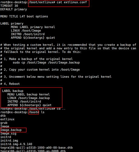

But when system bootup I can not see the uart printf information “============= IMX219 INIT ==============".

By default, kernel is read from rootfs but not partition.
So just replacing this to /boot/Image and it should take effect.

Because you are using uart to dump the log… and by default we set the verbose level to only print error on uart kernel log.
If you use dmesg to dump full log, you shall see your printk…

Dear WayneWWW,
I have to make corrections to the burn our own kernel Image.
There are 2 steps:
(1)Use the command : sudo ./flash.sh -r -k kernel jetson-xavier-nx-devkit-emmc mmcblk0p1
(2)Copy the Image to /boot/ to replace the /boot/Image .
Thank you.
The second step should be sufficient. No actually need the first one.
Suggestion: Save the original “/boot/Image” and add yours with a new name (e.g., Image-new) and have a new extlinux.conf entry for the new name. Then you can revert by a simple serial console choice if something goes wrong.

Your suggestion is really important. It can make me bootup the system if something is wrong with the kernel which I change.
I make changes as follows:
