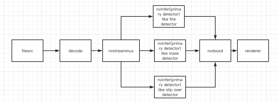

I made a workable YoloV4 version (here) based on the GitHub - NVIDIA-AI-IOT/yolov4_deepstream project, could you compare your config file and the files in deepstream_yolov4.tgz to check what the issue is.
Since the YoloV4 is already build as TensorRT engine, do you still want to run it with Triton/nvinferserver?
We need to deploy multi inference models to a source video. Could you give us some advice how to implement this more efficiently?
Hi
The config file you send to me are deepstream-app file, mine are deepstream-app-trtis file. I can not apply your config file to triton inference server
That’s why I ask “Since the YoloV4 is already build as TensorRT engine, do you still want to run it with Triton/nvinferserver?”
Using TRT should be able to get better performance than Triton
How can we deploy multi inference models through TRT? Our inference models include yolov4, yolov4-tiny and yolov5.
you can refer to deepstream deepstream-test2 sample which pipeline is like below:
Sample of how to use DeepStream elements for a single H.264 stream: filesrc → decode → nvstreammux → nvinfer (primary detector) → nvtracker → nvinfer (secondary classifier) → nvdsosd → renderer.
if the relation of your model is different from above, please elaborate so that we can give more accurate suggestion.
the relation of models like above
I think you can refer to deepstream_reference_apps/back-to-back-detectors at master · NVIDIA-AI-IOT/deepstream_reference_apps · GitHub which run two detectors in parallel with the source data from nvstreammux
Thank you so much! I will try this one right now~
One question, why don’t use one detector to detect all classes of objects?
Different teams are responsible for different inference models. To be honest, I think this arrangement is not reasonable.
Yes, this is wasting the computing resouce since using three models to do the work that can be done by one model
