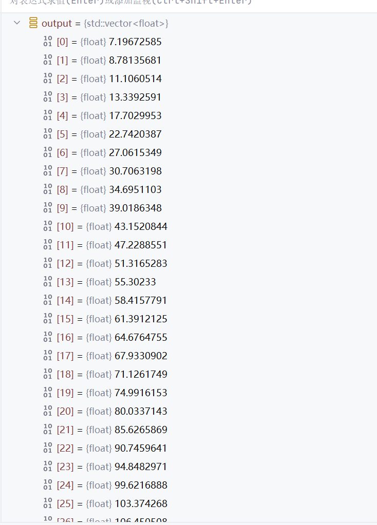

Yolov8 output wrong result, use Tensorrt
Description
I will transfer my ONNX model to Tensorrt, After completing a series of procedures, I obtained a very strange and unexpected result that was far from what I had expected.
I suspect there might be something wrong with my program, which is causing the engine not to function properly.
I suspect it might be a problem with the Tensorrt inference part, but I haven’t been able to identify the cause.
This is the output result of my program, It is increasing:
My module is 2 classes, It should be like this:
[x, y, w, h, c1, c2] * 78200

I sincerely hope that anyone can help me. Thank you very much.
Additional note:
I am using the Python version of ONNXRuntime, and this model can run normally.

    def __warm_up(self):
        dummy_input = np.random.random([1, 3, 736, 1280]).astype(np.float32)
        for i in range(5):
            try:
                # 进行一次推理,输入为 dummy_input
                self.ort_session.run(None, {'images': dummy_input})
            except Exception as e:
                print(f"Error during warm-up: {e}")
                sys.exit()
        print("ONNX session warm-up complete.")
    def __frame_resize(self, frame):
        frame_resize = cv2.resize(frame, self.imgsz)
        _frame_resize = frame_resize[:, :, ::-1].transpose(2, 0, 1).astype(np.float32)  # BGR2RGB和HWC2CHW
        _frame_resize /= 255.0
        _frame_resize = np.expand_dims(_frame_resize, axis=0)
        _frame_resize = np.ascontiguousarray(_frame_resize)
        return frame_resize, _frame_resize
    def __NMS(self, prediction):
        ### 一、 预测结果预处理 ##########################################################
        # 3.1 [1, 84, 8400] -> [8400, 85]
        _prediction = prediction[0]
        _prediction = np.transpose(_prediction, (1, 0))
        _max = np.max(_prediction[:, 4:], axis=-1)
        _prediction = np.insert(_prediction, 4, _max, axis=-1)
        # 3.2 去除低概率目标
        mask = _prediction[:, 4] > self._p_th
        _prediction = _prediction[mask]
        if len(_prediction) == 0:
            return None
        # 3.3 x,y,w,h转为x1,y1,x2,y2
        xyxy = np.zeros_like(_prediction[:, :4])
        xyxy[:, 0] = _prediction[:, 0] - _prediction[:, 2] / 2
        xyxy[:, 1] = _prediction[:, 1] - _prediction[:, 3] / 2
        xyxy[:, 2] = _prediction[:, 0] + _prediction[:, 2] / 2
        xyxy[:, 3] = _prediction[:, 1] + _prediction[:, 3] / 2
        _prediction[:, :4] = xyxy
        # 3.4 [8400, 4 + 最大概率 + 80] -> [8400, 4 + 最大概率 + 最大概率类别]
        max_index = np.expand_dims(np.argmax(_prediction[:, 5:], -1), -1)
        _prediction = np.concatenate([_prediction[:, :5], max_index], -1)
        ### 二、 NMS ################################################################
        # 1. 获取唯一类别
        unique_class = np.unique(_prediction[:, -1])
        if len(unique_class) == 0:
            return None
        # 2. 对每一类类别进行NMS
        class_boxes = []
        all_class_boxes = []
        for c in unique_class:
            # 1. 获取某一类别
            cls_mask = _prediction[:, -1] == c
            prediction_cls = _prediction[cls_mask]
            # 2. 按概率排序
            cls_scores = prediction_cls[:, 4]
            arg_sort = np.argsort(cls_scores)[::-1]
            prediction_cls_sort = prediction_cls[arg_sort]
            # 3. NMS
            while len(prediction_cls_sort) != 0:
                class_boxes.append(prediction_cls_sort[0])
                if len(prediction_cls_sort) == 1:
                    break
                class_iou = self.__iou_calc(class_boxes[-1], prediction_cls_sort[1:])
                prediction_cls_sort = prediction_cls_sort[1:][class_iou < self.iou_th]
        all_class_boxes.append(class_boxes)
        all_class_boxes = np.array(all_class_boxes)
        all_class_boxes = np.squeeze(all_class_boxes, axis=0)
        return all_class_boxes
    def __draw_boxes(self, frame, boxes):
        if boxes is None:
            return frame
        img_dataset = frame.copy()
        img_display = frame.copy()
        orig_img_path, dataset_img_path, display_img_path = self.__get_save_path()
        # 画图
        save_display_flag = False
        for box in boxes:
            x1, y1, x2, y2 = box[:4].astype(np.int32)
            p = np.round(float(box[4]), 2)
            class_id = box[5].astype(np.int32)
            if class_id == 0:
                area = (x2-x1)*(y2-y1)
                label = f"{class_names[class_id]}:{p} {area}"  # 获取类别名称
                cv2.rectangle(img_dataset, (x1, y1), (x2, y2), (255, 0, 0), 2)
                cv2.putText(img_dataset, label, (x1, y1 - 10), cv2.FONT_HERSHEY_SIMPLEX, 0.5, (255, 0, 0), 2)
                if p > self.p_th and area > self.area_th:
                    save_display_flag = True
                    cv2.rectangle(img_display, (x1, y1), (x2, y2), (255, 0, 0), 2)
                    cv2.putText(img_display, label, (x1, y1 - 10), cv2.FONT_HERSHEY_SIMPLEX, 0.5, (255, 0, 0), 2)
        # 保存
        if self.target_flag:
            cv2.imwrite(orig_img_path, frame)
            cv2.imwrite(dataset_img_path, img_dataset)
            if save_display_flag:
                print(f"{self.__get_time()}: get target")
                self.ser_0.write(b'\xAA\x55\x15\x55\xAA')
                print("串口数据已发送")
                cv2.imwrite(display_img_path, img_display)
        return img_display
    ### 工具函数 ################################################################
    def __check_dir(self):
        if not os.path.exists(result_file + 'orig'):
            os.makedirs(result_file + 'orig')
        if not os.path.exists(result_file + 'display'):
            os.makedirs(result_file + 'display')
        if not os.path.exists(result_file + 'dataset'):
            os.makedirs(result_file + 'dataset')
    def __get_time(self):
        current_time = datetime.now()
        # time_string = current_time.strftime("%Y-%m-%d_%H:%M:%S")
        time_string = current_time.strftime("%Y-%m-%d_%H-%M-%S-%f")[:-3]
        return time_string
    def __get_save_path(self):
        time_string = self.__get_time()
        orig_img_path = f"{result_file}orig/{time_string}.jpg"
        display_img_path = f"{result_file}display/{time_string}.jpg"
        dataset_img_path = f"{result_file}dataset/{time_string}.jpg"
        return orig_img_path, dataset_img_path, display_img_path
    def __iou_calc(self, b1, b2):
        # 提取坐标
        b1_x1, b1_y1, b1_x2, b1_y2 = b1[0], b1[1], b1[2], b1[3]
        b2_x1, b2_y1, b2_x2, b2_y2 = b2[:, 0], b2[:, 1], b2[:, 2], b2[:, 3]
        # 计算交集区域的左上角和右下角坐标
        inter_x1 = np.maximum(b1_x1, b2_x1)
        inter_y1 = np.maximum(b1_y1, b2_y1)
        inter_x2 = np.minimum(b1_x2, b2_x2)
        inter_y2 = np.minimum(b1_y2, b2_y2)
        # 计算交集区域的面积
        inter_area = np.maximum(0, inter_x2 - inter_x1) * np.maximum(0, inter_y2 - inter_y1)
        # 计算每个边界框的面积
        b1_area = (b1_x2 - b1_x1) * (b1_y2 - b1_y1)
        b2_area = (b2_x2 - b2_x1) * (b2_y2 - b2_y1)
        # 计算 IoU
        iou = inter_area / (b1_area + b2_area - inter_area + 1e-6)
        return iou
    def __On_Area_Trackbar(self, area):
        self.area_th = area
if __name__ == "__main__":
    yolo = Yolov8_ORT_MUL_Thread()
    yolo.run()
I’d be happy to help you troubleshoot the issue with your TensorRT inference.
Based on the information provided, here are some potential steps to help identify the cause of the problem:
  1. Verify the ONNX model: Before converting the ONNX model to TensorRT, ensure that the model is correct and functioning as expected. You can use tools like ONNX-GraphSurgeon to modify and verify the ONNX model.
  2. Check the TensorRT conversion process: Review the process of converting the ONNX model to TensorRT. Make sure that the conversion is done correctly, and the resulting TensorRT engine is properly configured.
  3. Inspect the TensorRT engine: Use tools like Nsight Deep Learning Designer to inspect the TensorRT engine and verify that it matches the expected architecture.
  4. Profile the inference: Use NVIDIA Nsight Systems to profile the inference process and identify any performance bottlenecks or issues.
  5. Compare with a baseline: If possible, compare the output of your TensorRT inference with a baseline output from the original ONNX model or another inference engine. This can help identify if the issue is specific to TensorRT or the conversion process.
  6. Check the environment: Ensure that the environment is correctly set up, including the Jetson Xavier NX, CUDA, and cuDNN versions.
  7. Review the code: Carefully review the main program code to ensure that there are no errors or issues that could be causing the unexpected output.
Some specific questions to help further troubleshoot the issue:
  • Can you provide more details about the unexpected output? Is it a specific value or a pattern that is incorrect?
  • Have you tried running the inference on a different platform or environment to see if the issue is specific to the Jetson Xavier NX?
  • Are there any error messages or warnings during the conversion or inference process?
  • Have you tried using a different version of TensorRT or the ONNX model to see if the issue persists?
By following these steps and providing more information, we can work together to identify the cause of the issue and find a solution.
