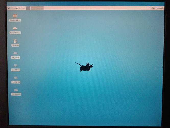

Occasionally i get scrambled X session screen when i start X. This happens in ~10% cases.
In some cases screen wasn’t scrambled but shifted downwards by ~50 pixels or so (mouse cursor moves in this shifted X screen area). In other cases part of X screen is rendered (quarter of it), being stretched all over display’s surface, with vertical stripes all over it (similar effect you see when you use magnifying loop on a CRT TV/Monitor).
To fix scrambled X session i have to switch to tty and then switch back to X session. Sometimes it helps, sometimes - it’s not and i have to use hard reset (in those rare cases it is even impossible to switch to tty) and pray next time i startx, i’ll get proper rendered X session screen.
Such driver’s behaviour was introduced since 304.60 drivers release. I had no such problems with prior drivers.
ps: i use fully updated Slackware 14.0, 32 bit; Geforce 7600GS, latest nvidia driver - 304.88.

According to your bug report, your kernel is not configured correctly:
Does the problem go away if you boot with the vga=normal parameter on the kernel command line?

The framebuffer console driver interferes with normal driver operation by accessing the hardware behind the nvidia driver’s back. We can’t support systems where a different driver is changing the contents of memory while we’re trying to use it.
Unfortunately, using “vga=normal”, didn’t helped. All i got is one weird things got replaced by others (though bug, preventing me switching to tty, still happens as well) - it’s like i’m using an old crt and having heavy interferences going on at the same time.
I repeat, in Windows XP i have no problems. And prior to 304.60 driver version i had no problems in Linux as well. So it’s not my graphics card is dying or something.
I’m attaching screenshot of this glitch and bug report.
