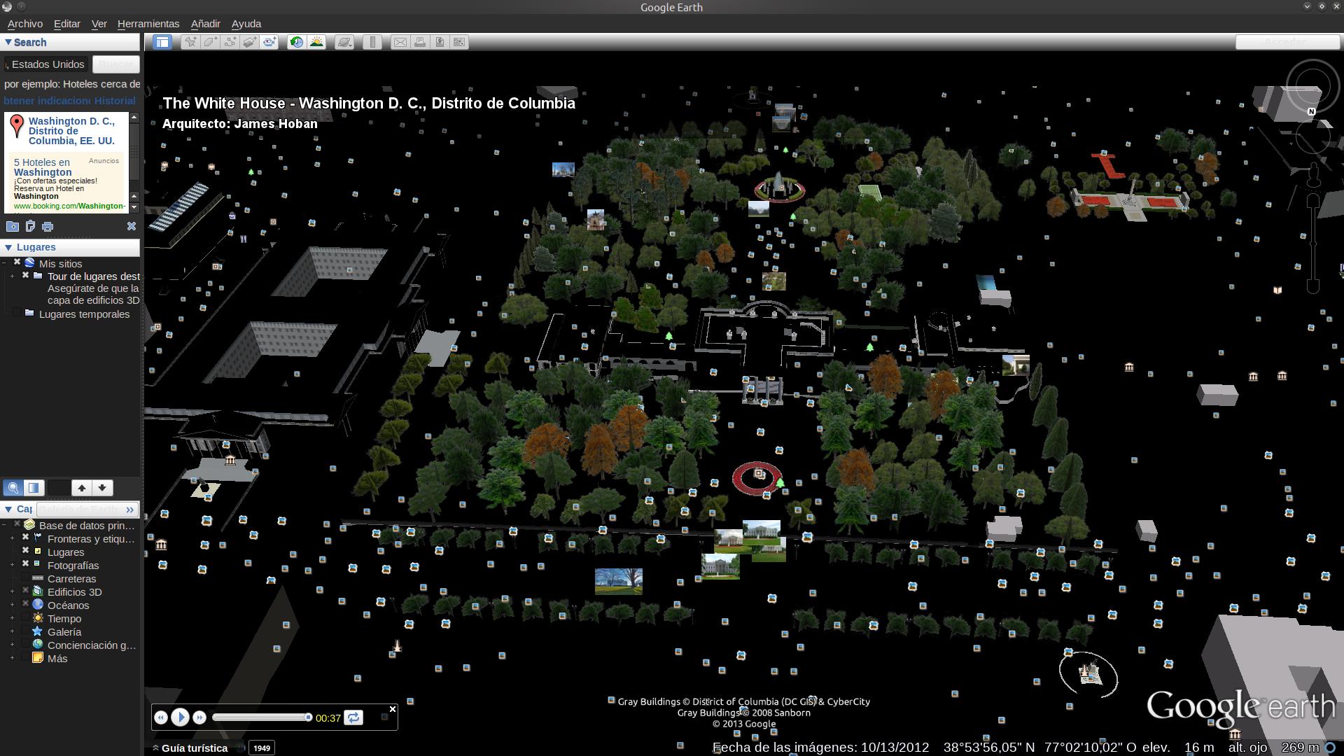

GoogleEarth almost works; 3d objects are displayed, terrain are displayed. However somehow, only satellite photo isn’t displayed.

What’s the kernel number? I’m using 3.12.0. And what is the version number of GoogleEarth? Mine is 7.1.1.1888. Mine shows only buildings w/o some texture. :(
My whitehouse:
Get closer:

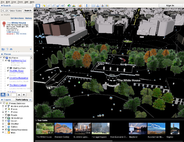

Again, what can’t you see? 3D models or something different?
i have same issue like maverick6664
the whitehouse turns to blackhouse

I can confirm this problem. Sat imagery (terrain) goes black with nVidia driver 331.20.
As a workaround, you can disable “Compression” in GE Tools → Options → 3D View → Texture colors.
(Unfortunately, disabling “Compression”, GE gets slower).
