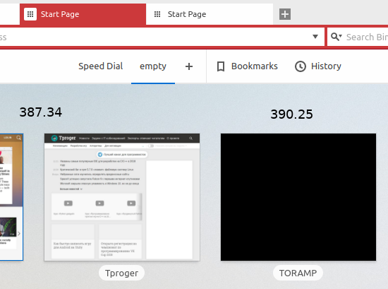

I’ve resolved my second problem for Vivaldi browser too:
There is a problem with previews for Start Page. It draws as black rectangles instead of page previews. It works correct with --disable-gpu for Vivaldi and it occurs only for 390.25, not for 387.34.
I think is is related. I can reproduce it with 390.25 for my Gentoo, Arch Linux and Ubuntu
