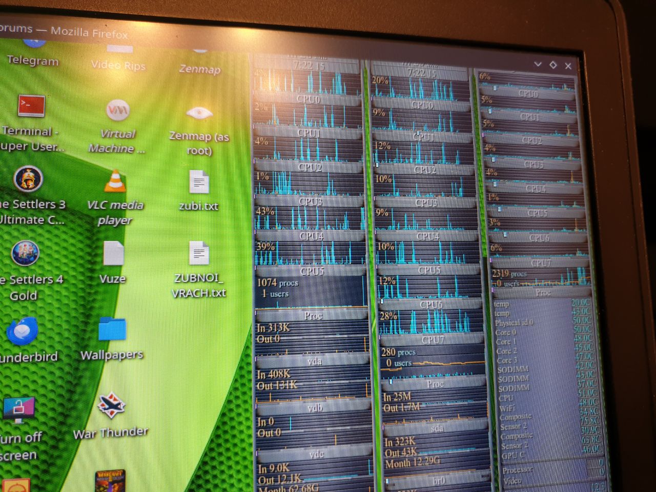

General problem. All works fine, but, if laptop goes to standby on wake up “minimezed” apps start either freezing (takes some 10 seconds to draw window contents out or shows total mess like with damaged video memory (random color palette on screen), I managed to photo first case (stall on redraw after wakeup and maximing app). It then operates normally, but somehow after standby such an impression that either nvidia lost memory contents so that it needs to rebuild data/cache or something broken there. Hardware itself is ok. On photo please look at top of screen, where top window border and header drawn
, but it’s contents not false pretending to be fully transparent, but simply nvidia hangs to draw contents.
System information: Dell Precision 7720, Nvidia Quadro P3000 (mobile), Opensuse Tumbleweed X86_64 (all latest packages), KDE desktop environment. Latest Nvidia beta driver for linux.
And aside from bug report, I want to thank a lot Nvidia for doing a great job in fixing previous bugs! Even despite of bug mentioned above, this beta driver is much better, faster and stable compared to latest stable release.

Issues returning from suspend / standby have existed for years. It isn’t anything unique to the 550 driver.
No. For me it was normal before 550. Maybe I am somehow lucky. On last stable releaso was long going to standby with texts about atomic commits fail with vsync or something like that
Your problem does sound different to the one this thread is about, so I’d recommend starting a new thread for discussion. However, from your bug report log it looks like NVreg_PreserveVideoMemoryAllocations is disabled. I’d recommend enabling it according to the instructions in the README and seeing if that helps.
