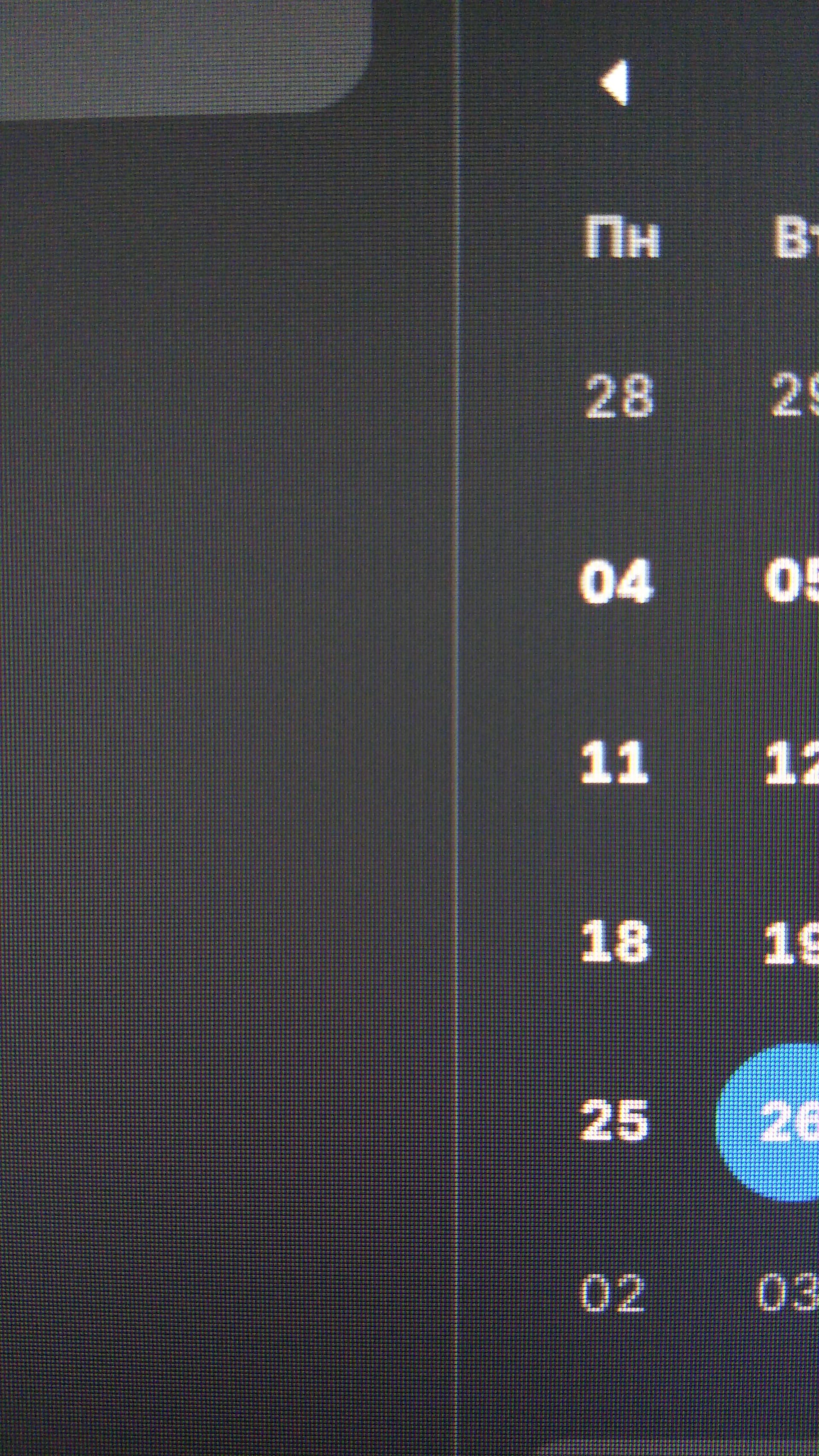

Question for GNOME users:
Do you have those vertical bars in the GNOME interface?
It’s very noticeable in settings, firefox or calendar like in the photo. Also some light colored sites become striped.
The stripes are not shown in the screenshots, but are visible in the photo.
For example, if you fill the canvas in Krita with color #353535 or #efefef, it will be striped.
Only rebooting once or several times helps.
Or rollback to version 560.35.03 It seems to solve the problem, at least I did not notice these stripes on this version.
I haven’t seen this problem in KDE, only in firefox.

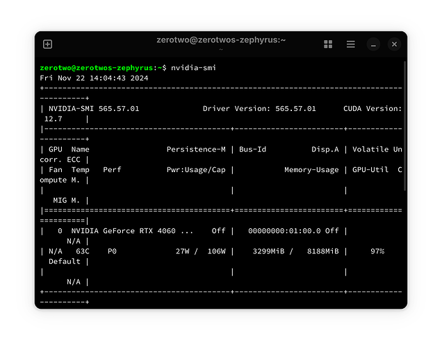

Still getting a weird issue, I faced it in 560 too,
where the game ā€œTHE Finalsā€ will not go above 30 watts of GPU usage (only sometimes) but sometimes i will use roughly 90 watts which is close to the 100 watts my 4060 Max Q should be capable of.
As i am not sure what part of the stack is causing it i have reported the bug to Proton, Embark (the developer of the game) and now here.
Sometimes the Power profile is p8 but most times it does go to p0 but still wont go above 30 watts giving laggy a nearly unplayable experience.
Generally a reboot gives me a 50/50 chance of the game working properly and it acting this way.
