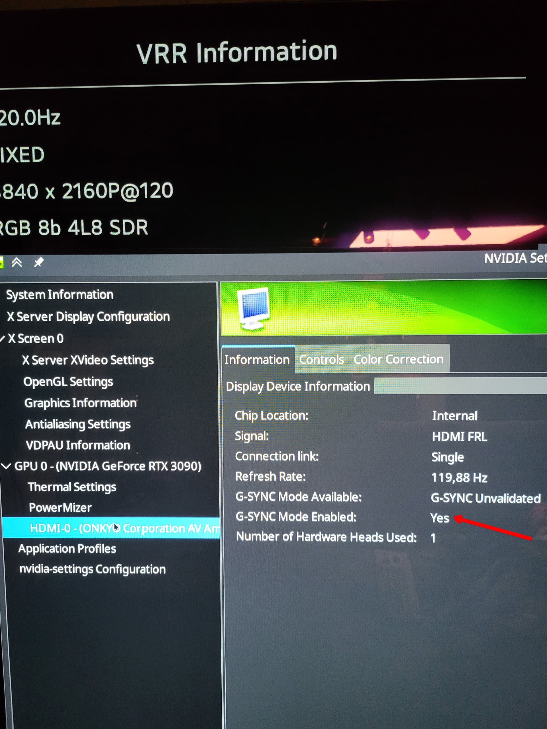

Unfortunately my display is not working for me at all when VRR is engaged on HDM2.1 with a single display. All I get is a black screen. I can alt tab and disable and then it works fine. Bug report attached.

No VRR with 570 driver. Back to 565…
Installed trough run file, /usr/share/vulkan/icd.d/nvidia_icd.json is messing for me.
Getting black screen for 1-2 seconds whenever I alt-tab out of a VRR enabled application on my 4k 240hz display. This is the same issue that was in a previous Windows driver. This behaviour is not on present Windows driver. But is certainly here on the current Linux driver.

Same issue with VRR over HDMI 2.1 - I have a G80SD 4k 240Hz monitor that works fine until VRR is engaged. Once engaged the screen goes black and no signal can be found. This does not happen over DisplayPort but this monitor has issues with DP that force me to use the HDMI connections. This can easily be replicated by setting KDE’s Adaptive Sync to “Always” or simply firing up any fullscreen VRR engaged app. 4090 on Gentoo here - works perfectly with the 565 drivers (which I have rolled back to).
