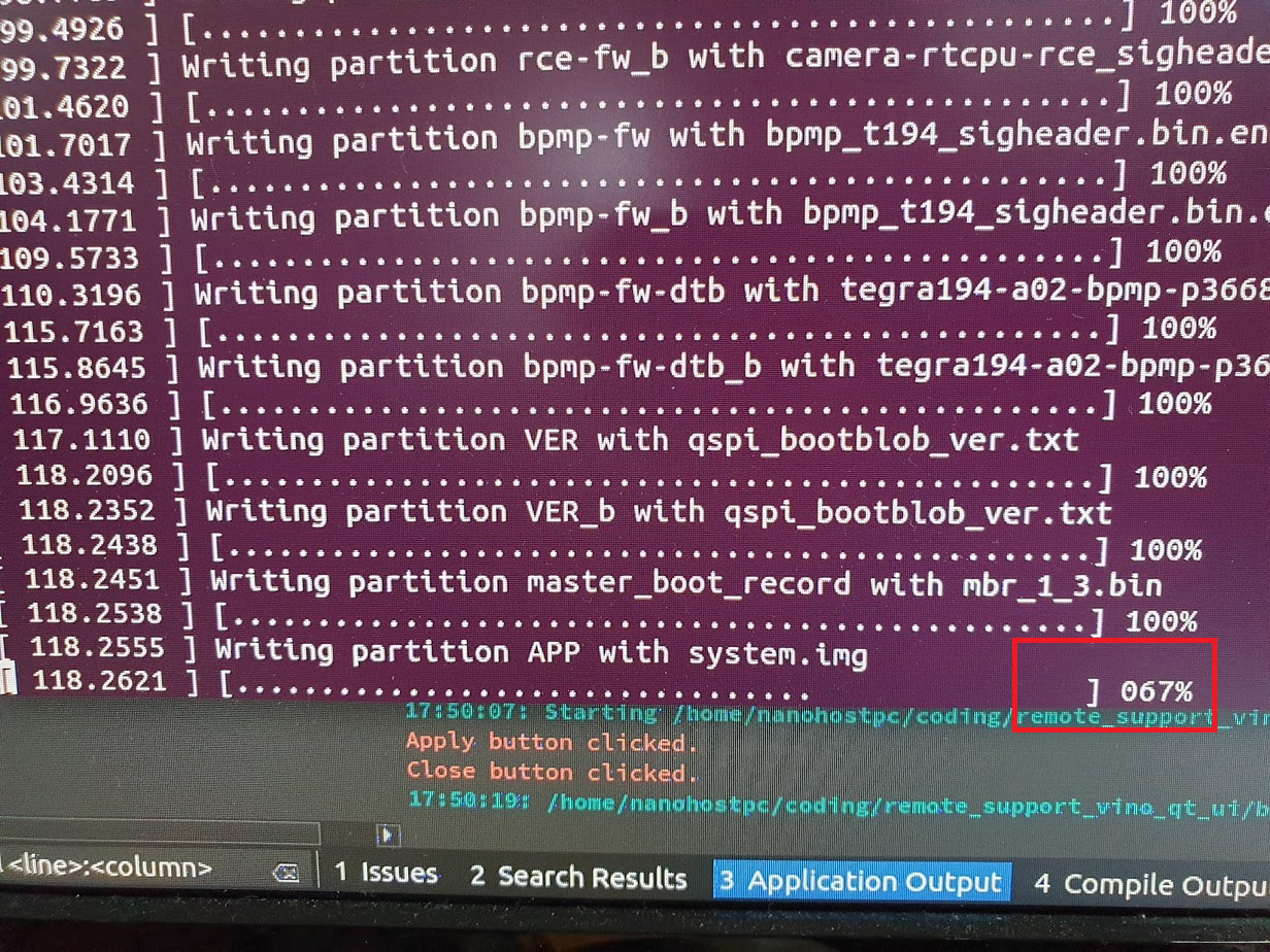

The flashing time of the xavier nx production module seems a bit long.
Can you tell how many minutes it usually takes?
Thank you.
Yes, other forum user asked this before.
It may take 8 min to flash production module because of the qspi on it.
My nx module has been installing for about 47 minutes now.
It’s going on, so it’s not stopping
What’s the problem?
Thank you.
That is weird. Is the progress bar still moving forward?
Yes
Isn’t it worth waiting?
If it takes so long, can there be a problem?
Thank you.
Are you using any customized rootfs? or just a pure one from jetpack?
Pure
