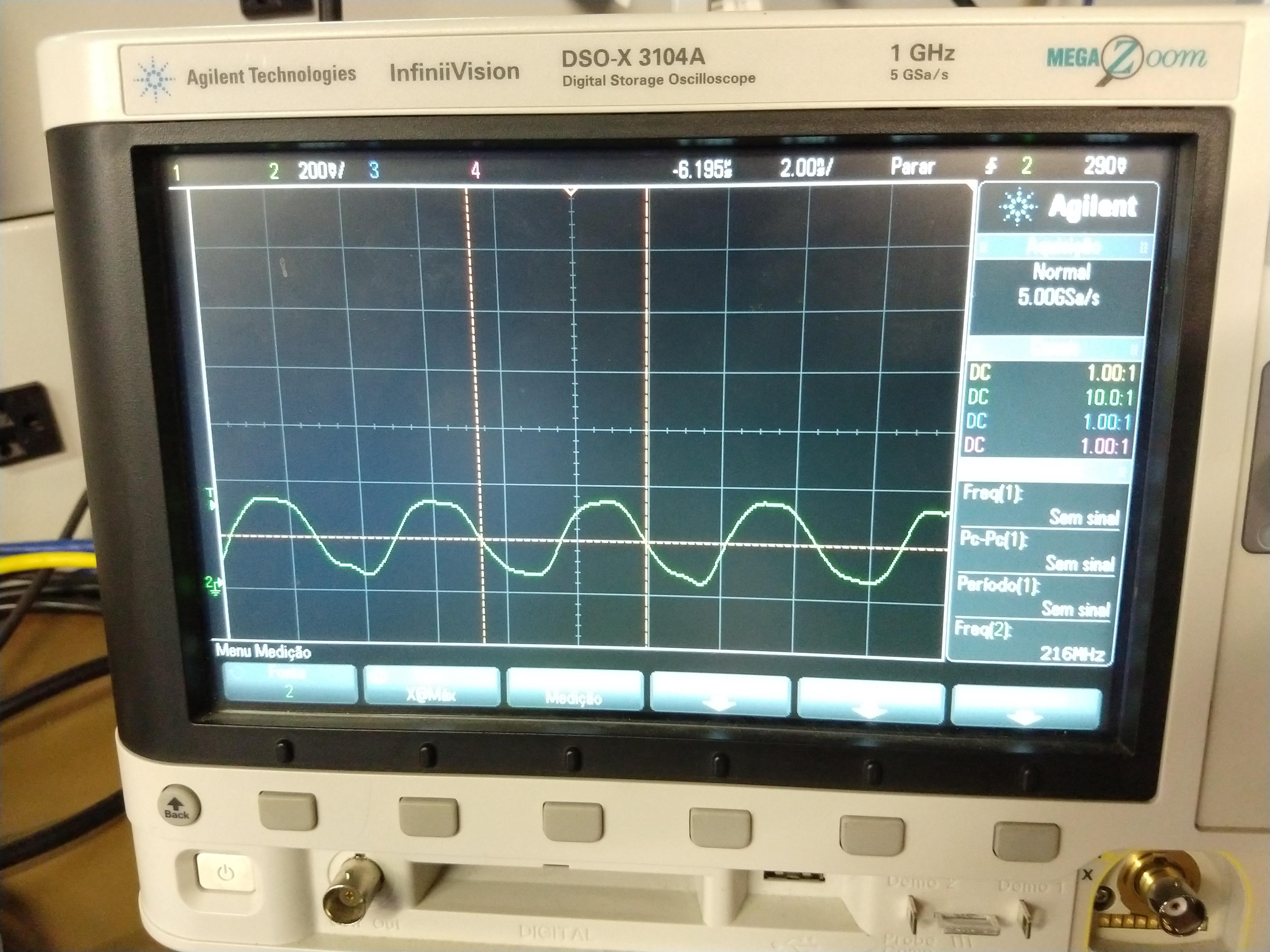

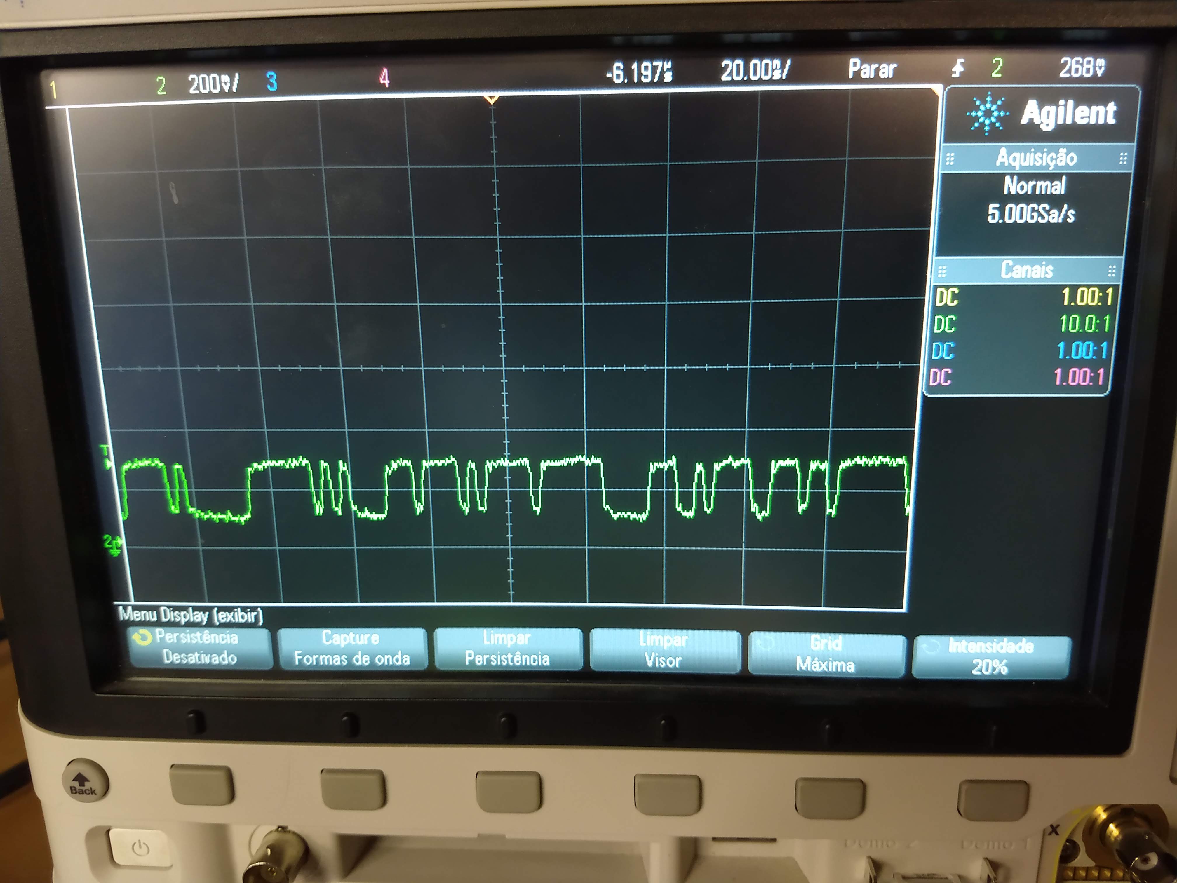

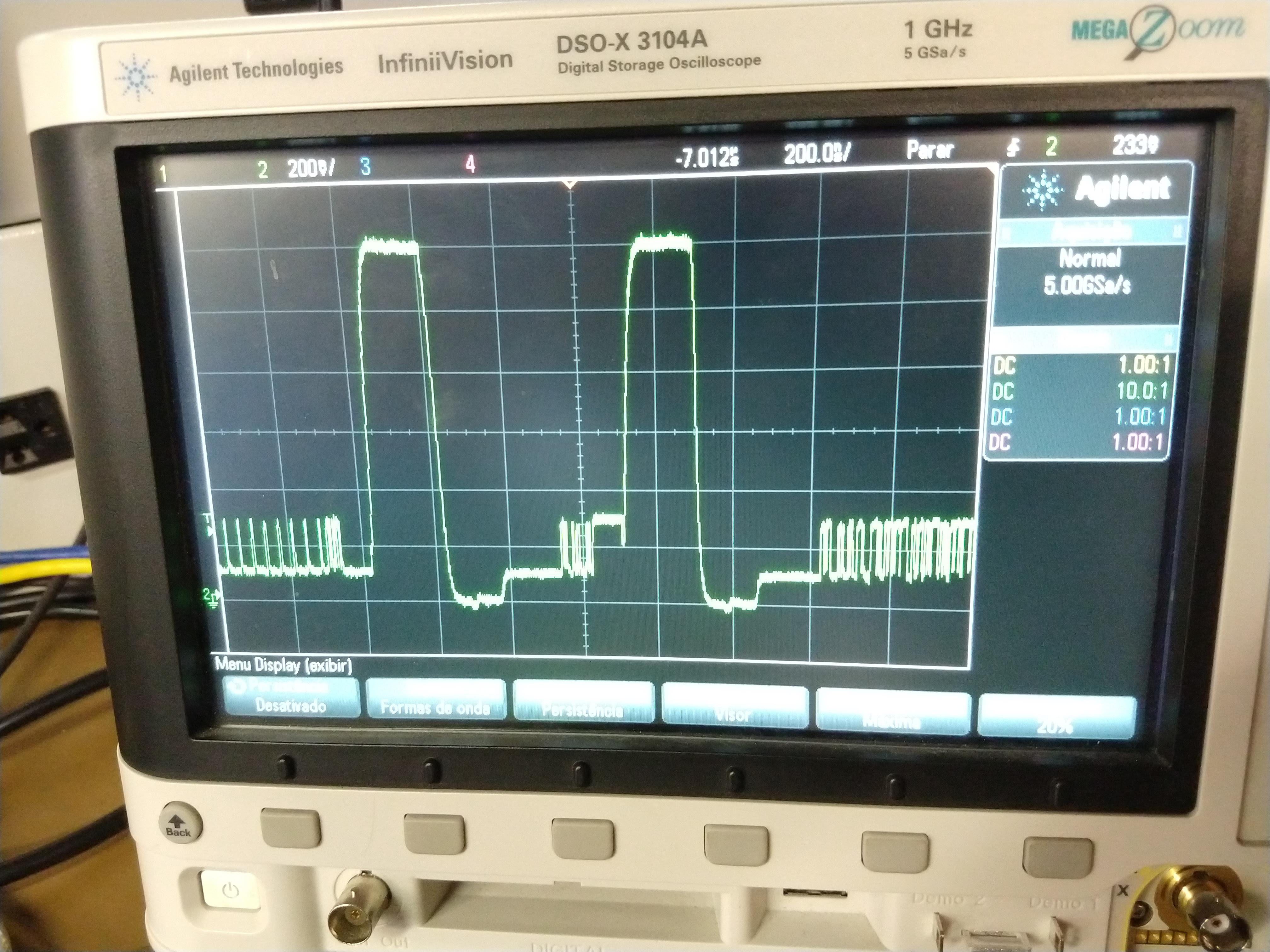

Hello Jerry.
I’ve measured the signals with a 1GHz oscilloscope and I’m sending the waves to you.
The CSI2 signal looks very good, I can see the low-power and the hi-speed parts, and when I zooming the signal the hi-speed bits looks very good, they are differential but I’m getting as a single, TX2 “see” it as differential and the quality will be very better, so I think there’s no problem to TX2 get this signal.
I’m sending the CSI2 clock waves too.
When I was measuring the signals, I try to cover the camera lens (There’s a analog camera plugged on ADV7280M input) and I can see that the bits pattern (hi speed) change. Also when I unplug or turn off the camera the signal change a lot (it turn in a very repetitive pattern suggesting a “black screen”)
Check the attached images, please.

hello alfredosalvarani,
port-index = <0>; bus-width = <1>;
these means enable CSI-A for 1-lane configuration to receive sensor signaling.
  1. could you please configure the system as performance mode for verification. you might configure it as MaxN for testing, please refer to Supported Modes and Power Efficiency.
  2. could you please check if you’re sending packages with embedded metadata?
  3. you should also note that VI engine expect the signaling package following with SOF/EOF/SOF…EOF.
    thanks
