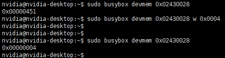

Okay, I have successfully verified it. I’m currently testing the use of the busybox tool to configure the GPIO direction (input/output). I found the offset address for GPIO3_PCC.02.
So I read the value of register 0x02430028 and modified it to set the pin as an output and also changed its pull-up/down configuration.
However, I noticed that the output level of the GPIO doesn’t change, and I’m not sure what the issue is. I would appreciate your help with this.

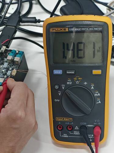

First, I wrote 0x04 to register address 0x02430070 to configure the pin as GPIO output mode.
Then, I tried to pull the GPIO high and low using the following commands, and measured the voltage with a multimeter.
However, I found that the GPIO remained at a high level.
This is the verification process I followed, so I suspect that the register configuration did not take effect.If there’s anything wrong with my verification approach, please kindly point it out. Thank you!
Thanks for your clarification for your verification steps.
0x02430070 seems the pinmux register for PQ.06 rather than PCC.02
From your screenshot, I don’t know why you used 0x02430028 .
If you want to control PCC.02, please configure pinmux register 0x0c302028 instead and run the same gpioset command to control it.
