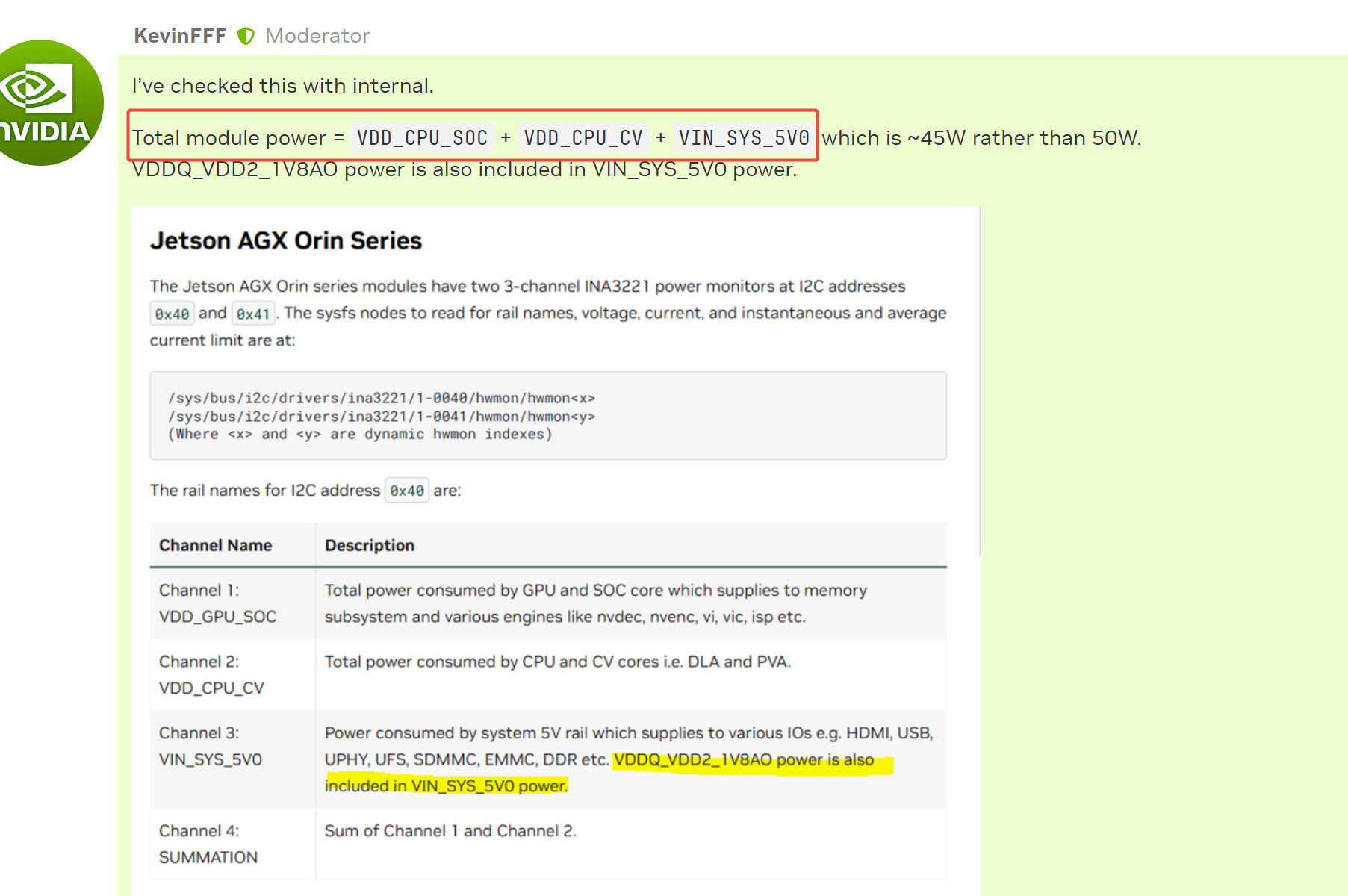

How to calcute the consumption? It is VDD_GPU_SOC + VDD_CPU_VC or VDD_GPU_SOC + VDD_CPU_VC + VIN_SYS_5V0 + VDDQ_VDD2_1V8AO ?
From the documentation: Jetson Orin Nano Series, Jetson Orin NX Series and Jetson AGX Orin Series — NVIDIA Jetson Linux Developer Guide
How to calcutate the 30W consumption?
This could answer.
Hello @WayneWWW
Thanks, so from the documentation, the full consumption shuld be:
VDD_GPU_SOC + VDD_CPU_VC + VIN_SYS_5V0 + VDDQ_VDD2_1V8AO, right ?
There are other contributors but those rails are the largest consumers of the 30W budget for the module.

Just another topic talk about the samilar issue.
From the topic, the Total module power = VDD_CPU_SOC + VDD_CPU_CV + VIN_SYS_5V0
But the test from our side is strange that, if we setup the MODE_30W above,
30W Total module power = 9.8W + 4.1W + 7.9W = 21.8W, can't reach 30W.
If we setup to MAXN,
Total module power = 47W + 13W + 10W = 70W, it exceed 60W, why this happend?
