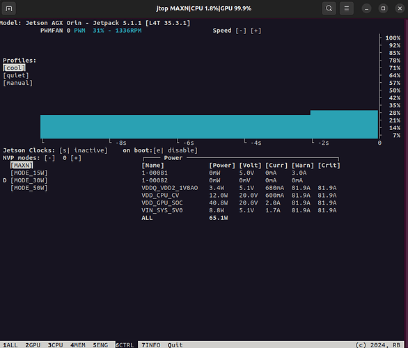

I have a question, my jetson is 32gb but has 4 profiles, 15w, 30w, 50w, and maxn
for the maxn, is there a set cap for the board?
The cap value is for maxn mode.
I have a agx orin of 32gb and it’s using 65w
So it isn’t true that cap value is for maxn mode, because it is using 65w and it’s an agx orin 32gb, while given what you said it should go up to 40w
You can refer to below links for more detail info.
https://docs.nvidia.com/jetson/archives/r35.3.1/DeveloperGuide/text/SD/PlatformPowerAndPerformance/JetsonOrinNanoSeriesJetsonOrinNxSeriesAndJetsonAgxOrinSeries.html?#jetson-agx-orin-series
By default, the power limit of a 32gb agx orin is 45w? why curr1_limit is 81.9A? can i modify it?
In curr4_crit I have this limit: 3240mA which seems to be the current limit for Channel 4: SUMMATION ?
and voltage is 20V
The question here is based on the docs you provided, instantaneous power limit seems to be 45W for 32gb, but then, curr4_limit tells me it’s 65w (3240mA * 20V)?
Also, if channel 4 limit was 45w, which is the sum of VDD_GPU_SOC and VDD_CPU_CV, why the sum gives me 52W?

Now I am wondering what’s up with the curr4_critical is showing me 3240mA which means that the power limit is 65W for the 32gb version, are some dev kits configured differently? or is my dev kit badly configured?
I will assume the limit is 65W for the MAXN profile, since it’s actually going beyond the 45W specified by the docs.

Yes, the model reported by jetson_release is:
Model: Jetson AGX Orin - Jetpack 5.1.1 [L4T 35.3.1]

for gpu i have used the stress test and observed the frequency of the gpu, it’s 1.3 ghz in maxn mode (it corresponds to the 64gb version instead of the 32 one, Jetson Orin NX Series and Jetson AGX Orin Series — Jetson Linux<br/>Developer Guide 34.1 documentation look at the frequency tables for gpu in maxn mode for both 32gb and 64gb versions)
the last link you’ve provided is broken
everything points out to the 64gb version
I’ve had the idea to look at the S/N number in the box and compare it against the one reported by software, they do not match.
Okay, looking at the board s/n and the box s/n i could see it’s the 32gb version, so that’s confirmed.
So that’s solved, the next question is why gpu clocks, power modes, vdd_cpu_gpu_soc exceed the ones of the 32gb? Instantaneous power shouldn’t be more than 45W, but i’ve seen it go to 52W (even exceeding it)
