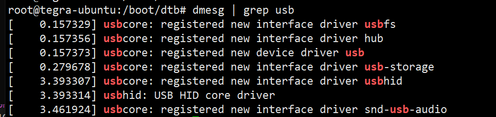

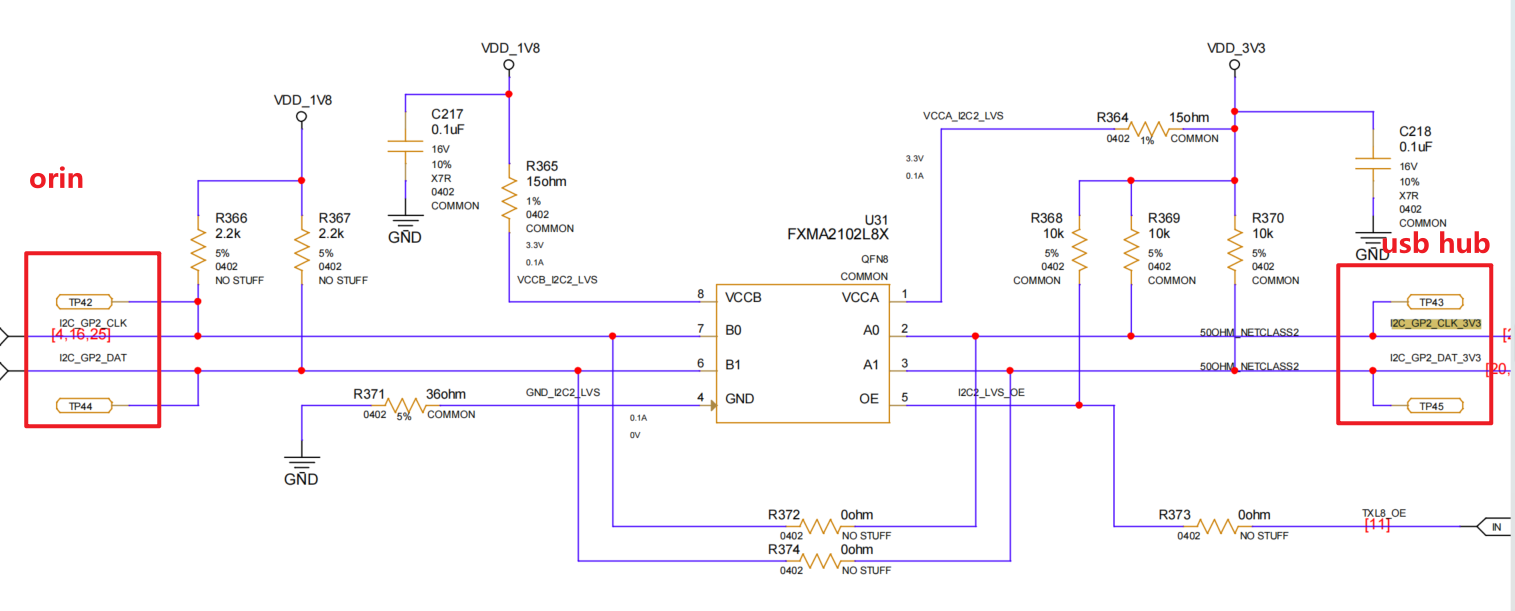

Similar to the design of the AGX Orin kit, we used the USB hub chip RTS5420-GR to implement two USB 2.0 ports (USB3.0), but the two USB ports did not work. The specific design is as follows:
1、schematic design
2、log and dts
dmesg.log (209.0 KB)
dts.log (819.0 KB)
Please assist in analyzing the problem.
If it is a device tree configuration issue, how can it be configured? It’s a modification i2c@c240000 and xusb_padctl@3520000 Are these two nodes?
I refer to operation Jetpack 6.1 and USB on Custom Board - #10 by nzamani and currently can achieve USB functionality, but I do not understand the working principle of AGX Orin’s USB, XUDC@355000 The XHCI@3610000 The Xusb_padctl@3520000 、 What are the different types of typec? Which USB controller is USB 2.0 or USB 3.0 related to in our schematic?
If RTS5420-GR is suspended i2c@C240000 Why can’t I scan through the “i2cdetect - y 1” command under the node?
You need to disable everything that is not in use on your board from the device tree related to USB.
For example, if typeC from Cypress PD controller is not in use, then you need to remove them.
Jetpack6/kernel5.15 will check these dependency. If any of them do not exist there, it will stop the drover probing.
So actually your usb driver is not up at all. Without driver, hub would not work for sure.

The flash of the hub (RTS5420-GR) burned firmware, and the i2c interface may not be in use at this time, so the “i2ctest - y 1” command cannot find any i2c slave devices.
If the hub (RTS5420-GR) does not load programs from flash, I believe Orin needs to configure the hub through I2C.
Cypress PD controller is in use, and we are analyzing why i2c@c240000 Remove nodes typec@8 Why is the post hub controller working properly?
