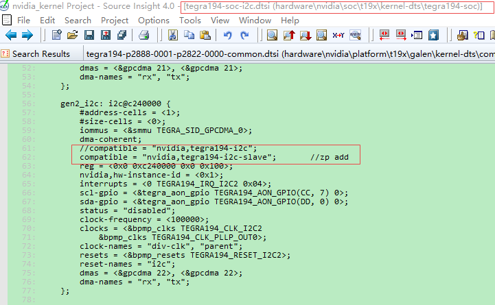

i want to know how can i set the i2c@c240000 as a slave i2c node

Hi JerryChange
i add a code in the dts, the code can be a slave mode ?
it can be compatible with the other master mode node?
hello zp11,
there’s I2C slave controller supported,
please check the kernel documentation for Linux I2C slave interface description,
for example,
$L4T_Sources/r32.6.1/Linux_for_Tegra/source/public/kernel/kernel-4.9/Documentation/i2c/slave-interface
