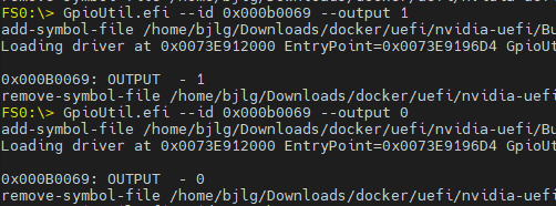

I have tested the input function.It is ok.
But when I test output function. I found that even if I set GPIO27(PN.01) to 1(high-level),the output level of gpio27 is unstable,most time it is still low.
but my colleague says that it may need a pull-up resistor.
Is it right?
Thank you so much!
Have you tried to use sysfs to control this pin (PN.01) with the same issue?
and what do you mean “most time”? Do you mean it could be controlled as expected sometimes?
Yes,it is.I set GPIO27(PN.01) to 1(high-level) successfully twice. But I cannot repeat it now.
I try it just now and find that it is ok by using sysfs to control this pin (PN.01).
I also tested GPIO35(PG.00).The test results are the same. when using sysfs to control these pin,output function and input function are both okay. But when I tested it in UEFI,the input function is okay. the output function is wrong. I can not set these GPIO to output high level in UEFI.
When I tested GPIO27(PN.01).I used gpio-id 0x000B0069.
When I tested GPIO35(PH.00).I used gpio-id 0x000B0038.

It seems both of these pins configured as input as default in pinmux.
Could you help to update pinmux to configure them as output before control them in UEFI?

Problem solved.
It is okay after updating pinmux to configure them as output .They can be controlled as expected.
But the input function is not okay now. That means the direction of gpio can not be changed in UEFI.
