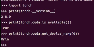

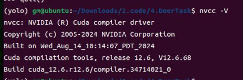

I am currently running my own model in a virtual environment on the Jetson Orin Nano Developer Kit with the following software stack: JetPack 6.2.1, CUDA 12.6, and PyTorch 2.8.
However, I keep encountering the following error when executing the model:
处理错误:Error in dlopen: /home/gm/miniforge3/envs/yolo/lib/python3.10/site-packages/torch/lib/libtorch_cuda_linalg.so: undefined symbol: cusolverDnXsyevBatched_bufferSize, version libcusolver.so.11
I have searched online but could not find a working solution.
Has anyone else experienced this issue, or does anyone know how to resolve it?
Below is a summary of my current environment:
I installed JetPack and CUDA using the NVIDIA SDK Manager.
For PyTorch and torchvision, I followed a recommendation from the forums and installed the packages from this repository:
jp6/cu126 index .
The following screenshots show the check of my system:

Hi dnk, you may want to ensure that you are at least using CUDA Toolkit 12.6U2 as the API was added in that release
Best,
Christoph

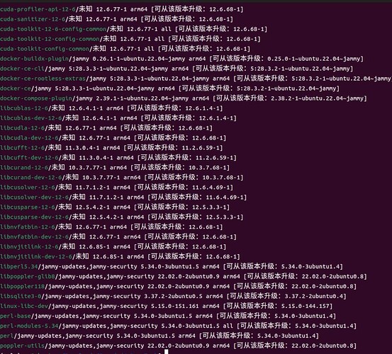

Hi,Thank you for your response.
I have updated the CUDA Toolkit to version 12.6 Update 3 by using the
and have reinstalled the pytorch, but the same error still persists.
I ran the command apt list --upgradable and saw these packages listed.
May I ask if I still need to update them?

Hi, thank you for your response.
Inspired by your suggestion, I updated my libcusolver and libcusolver-dev by sudo apt install --reinstall libcusolver-12-6 libcusolver-dev-12-6 , and I am now able to run successfully.
Thank you once again!
I have identified the issue: after updating CUDA to 12.6 U2, it was also necessary to update libcusolver and libcusolver-dev. After doing so, the code runs successfully.
Thank you for your assistance.
