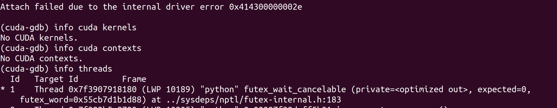

Attach failed due to the internal driver error 0x414300000002e with cuda-gdb
On a Linux server, when I try to attach a running process with cuda-gdb, I would receive such an error after lots of reading symbol from a .so lines.
But the cuda-gdb seems attached to the target process, however it losed all things as a CUDA gdb instead of a vanilla gdb. I can’t inspect anything related to CUDA, but I can still look into CPU-side things like threads, as the following figure shown.
And this error only appears when attach to a running process. If I run a process with cuda-gdb,
cuda-gdb python myscript.py
then it just works and I could inspect things like cuda contexts.

Hi @odyssey471
To help us identify the issue, could you provide a few more details about your environment:
  • Please share the complete cuda-gdb output when attempting to attach.
  • Please re-run the attach with additional logging enabled:
    • Add NVLOG_CONFIG_FILE variable pointing the nvlog.config file (attached). E.g.: NVLOG_CONFIG_FILE=${HOME}/nvlog.config
      nvlog.config (539 Bytes)
    • Start the application.
    • Run the cuda-gdb attach command.
    • Wait for it to fail.
    • You should see the /tmp/debugger.log file created - could you share it with us?

Hi @AKravets
By using newer driver (570.172.08) and newer cuda-gdb (12.0, previous version is 10.1 from Ubuntu 20.04 apt sources), I solved this issue.
Thanks for your help!
