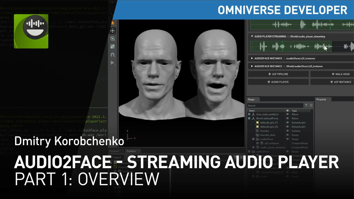

Did you solve this issue? I have the same problem with “Audio Player Streaming: instance does not exist” - I tried all the different instance names mentioned.
I also checked this old video on how to use test_client.py but could not get it to work either (the video uses and older version of A2F which seems quite a bit different):
I had to run the script in Powershell instead of the Git-bash and it worked, otherwise Im getting the same error.
