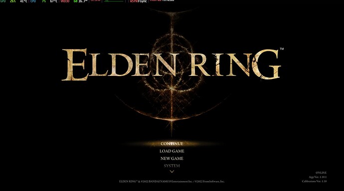

Update: i’m on NixOS currently. Made generation with 535 driver. Set vsync=0 in manhogud.
Plasma 6.
Elden ring. Mangohud + gamescope. Vsync=0
Dota 2. mangohud with vsync= 0, but without gamescope in this time
As we can see in these screenshots, Mangohud reports that these games are running on FIFO_RELAXED_KHR.
I saved the NixOS generation with the 535 driver in case more info is required."
