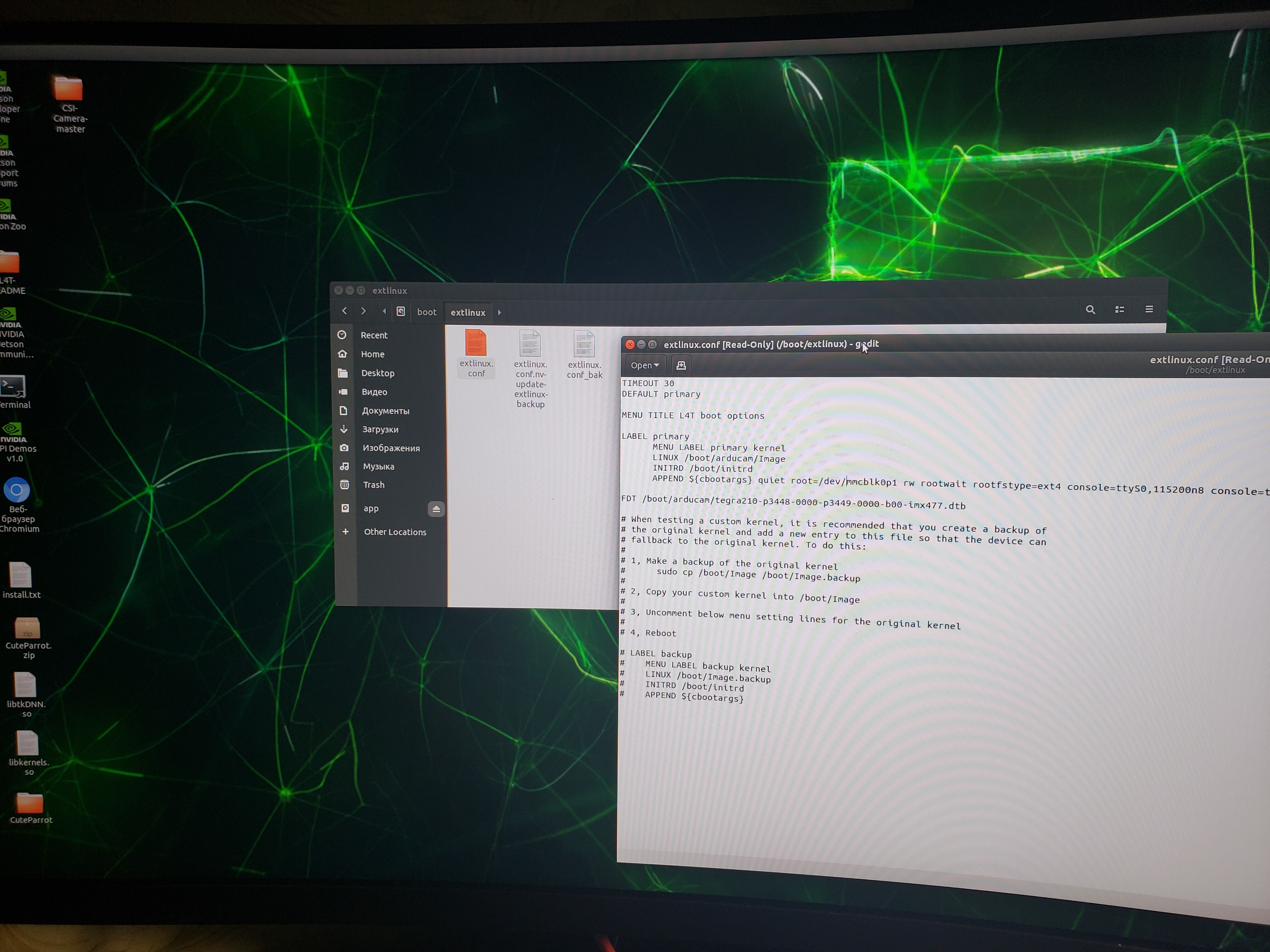

Boot from USB SSD after adding FDT /boot/arducam/tegra210-p3448-0000-p3449-0000-b00-imx477.dtb in extlinux.conf
Continuing the discussion from JetPack 4.5 Production Release with L4T 32.5:
Please give step-by-step instructions on how to do this on jetson nano 4gb. I’m new to this. Installed everything with a script IMX477 - 12MP HQ Camera - Arducam

I have one question first
  1. What was your method to boot from usb drive? It looks like you even not able to boot into it.
  2. We will deal with FDT after (1).
Does this file exist on your usb drive?

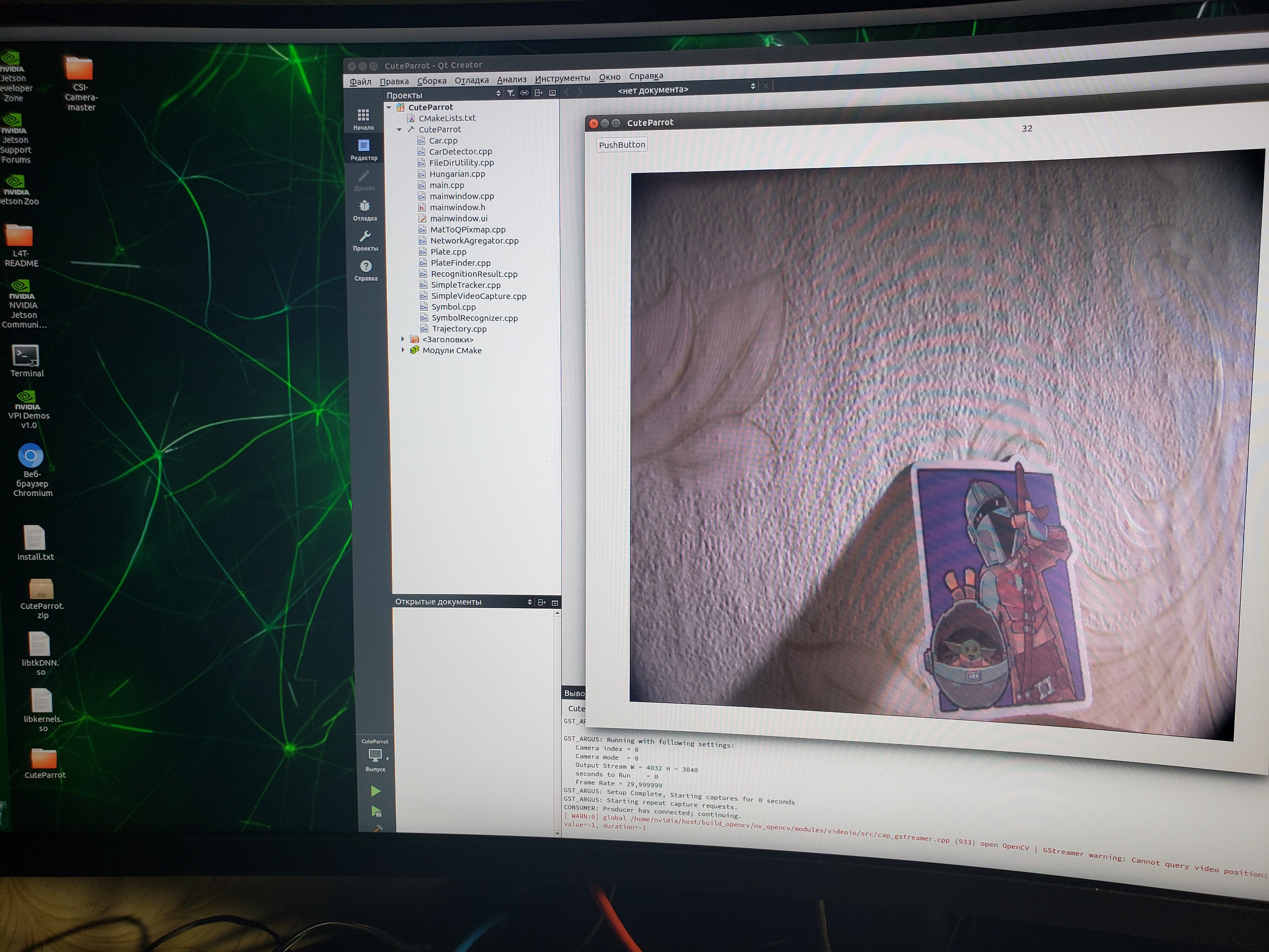

After this script IMX477 - 12MP HQ Camera - Arducam boot not work
On second photo
If i boot from sd card all work and camera too. So arducam image and fdt working…
There are few things I would like to suggest
  1. For the boot from usb drive, I would suggest you can use the method from our official document.
    https://docs.nvidia.com/jetson/l4t/index.html#page/Tegra%20Linux%20Driver%20Package%20Development%20Guide/flashing.html#wwpID0E02L0HA
  2. However, even if (1) is done, actually I am not sure what this script from IMX477 - 12MP HQ Camera - Arducam is doing. This is a camera vendor so I am not sure what they did. Please check if USB drive still has kernel file on it.

Hi sir,
Another suggestion for you… if you want to upload a picture, please add some explanation to it…
I really don’t get what you want to say here. Especially you post a baby Yoda image in the second one… which seems not related to this issue…
And what I said ā€œplease check if the kernel file is really existing on your driveā€.
The bootloader is trying to search ā€œ/boot/arducam/Imageā€ on your device and it fails. That is why your uboot cannot boot into OS.

Put the Jetson device into recovery mode - how to do this?
Please start from quick start guide. You should learn it step by step. Also need to get familiar with sdkmanager.
Image existing, and it working from sd card.
Thanks for the solution.
